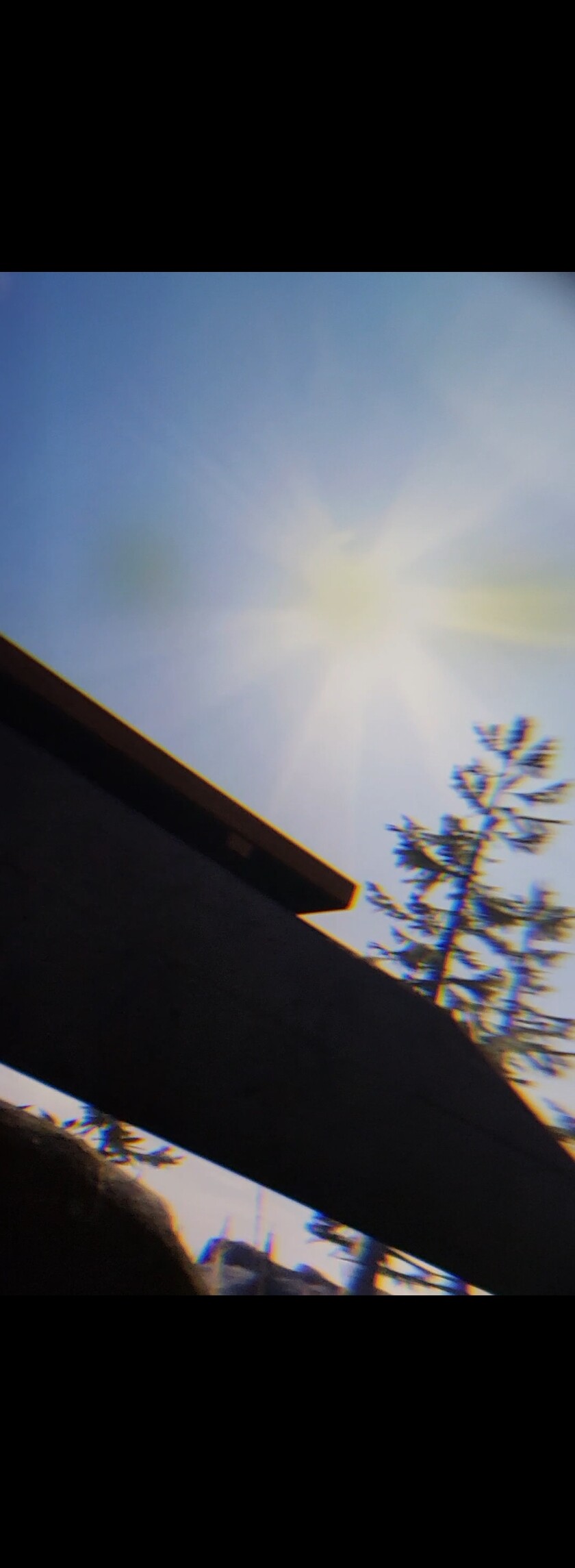

  1. After using the HMD after 30-60min, I get a spot (green-yellow colour) on the left lens/ panel, and after another 30-60min, I can see even 4 of them. Anyone here with the same experience??? ##ticket open already but no answer so far##
    Note: after 10-15min cooling down the headset, these spots are gone but can show-up again after some use (heat issue?? defective panel?? - see pictures-

I get the same thing on the left screen. Have played for about 1 hour yesterday and 6 of these spots appeared. But when I turned the screen off and back on right away they disappeared.
It shouldn’t be a heat issue because I did it instantly (after about 2 or 3 secs). But to be honest I didn’t play for long afterwards so the screen might have not reached the same temps.

I received my Crystal yesterday, so latest revision of firmware and also latest software installed and today after a couple of ours of play I already have those green spots appearing. Interestingly they first appeared on the left screen and were getting bigger (vertically), but disappeared after quick sleep/wake up cycle of the headset. But moment later some spots appeared on the right panel and again disappeared after cycling sleep function. I stopped playing shortly after, so don’t know if they would reappear. It happened during MSFS2020 play with OpenXR, not SteamVR.

Same issue here. Faint brownish splotches started as a few smudges up top, moved around/morphed while in game(DCS) and now is several (6?, more?) in an arc across the top of the Crystal display. I’ve had the unit for 2 days and just noticed it this morning. Submitted a ticket.

i have the same issue with the yellow spots. The answer to my ticket from Pimax is:
“This problem is mainly due to the screen temperature, we currently recommend that you try to reduce the temperature of the headset by external means as much as possible. If this occurs, you can turn off the device and stand still for a longer period of time.”
