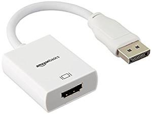

But the pimax would require a dp1.4 socket
Active hdmi to dp1.2 adapters(Adapter HDMI to DisplayPort - 4K 30Hz - HDMI & DVI Display Adapters | StarTech.com United Kingdom ) are available but would they cause lag if used to connect the vive wireless receiver to the pimax dp connction .
The pimax wants dp.1.4 but from what i can understand is that dp1.2 can provide 1440p at 100hz if all 4 lanes are used ???

How will you plug it in? Pimax uses a non-standard connection in the HMD… If the wireless module accepts USB and DP, you’d still need to plug into the end of the Pimax cable… I guess you could then wrap the cord around your waist 10 times?

Yeah… so I get that adapters are possible, but it’s a custom connector. You can’t just go buy one on Amazon. You might be able to find someone that makes the relevant connectors and crimp / solder something together, but that’s going to be janky.
