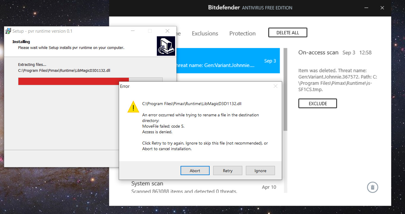

@PimaxQuorra, just uninstalled 271 but I can’t properly install 270. BitDefender blocks a file as having a Trojan or virus:
I see @Trigen had this too. If most AV software doesn’t consider it a threat I guess I’ll have to take the risk and except it.
https://community.openmr.ai/t/libmagicd3d1132-dll-error-occured-trying-to-rename-file-access-denied-trojans-we-page-unsafe/36859
I had to temporarily except the whole \Pimax\Runtime\ folder to get 270 to install. But now that’s done, things seem to be working normally again.
