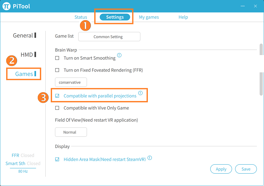

What games are you trying to play? Do you have to use parallel projection for these games to work? Is it enabled in PiTool? I have found that I get the double vision thing when the game needs PP but it was not set to on in Pitool. Also have you recently updated the Pitool software, headset’s firmware, the graphics card drivers on your PC? All of those things could cause issues like this.

What you are describing is a common issue when a game is not fully compatible with the Pimax’s angled screens. In PiTool, go to this page and make sure PP is on. It’s a compatibility mode (which lowers your framerate because your GPU has to render more pixels). If you have a very good video card, you might be able to leave it enabled all the time, otherwise you should only enable it as needed.
FYI - Sometimes the PiTool settings get reset, so if you have any trouble, it’s a good idea to double check and verify that the options are still set appropriately.
Yes parallel projection must be enabled with certain games

Remember to restart SteamVR after changing that setting
They!!! Everything is alright!!!
