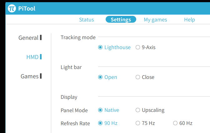

@Octofox Does the 90 Hz mode work for you? Just upgraded to 472.47 (the latest Studio driver) and I only get black. 72 Hz native and 114 Hz upscale both work. Undecided whether itās worth to roll back again or forget about the 90 Hz mode until Nvidia/Pimax get it working with a current GPU driver version (and optimally all versions after).

Just do be sure: So, you were able to enable the 90 Hz refresh rate native mode for the 8kX with current Nvidia GPU drivers? (Not so much concerned about 90+ fps - this depends on PC hardware, game, settings etc. - but more whether you see anything at all in 90 Hz mode)
Yes absolutely. Iāve had 90Hz native mode set for a while since whenever the PiTool and firmware versions allowed for that, and itās still set and working for me with the latest Nvidia driver (released 1st December) - no black screen.

Ok, first I upgraded to PiTool 271 (from 270) which turns out to still work for me (273 doesnāt) which is supposed to allow newer Nvidia drivers with 90 Hz.
Tested with the latest game ready driver 497.09 and went back to the original cable. Still no picture with 90 Hz. It might be the 298 beta firmware that I am still using?
(Tried again to update to firmware 299 again - no chance, just a yellow led, have to return to 298.)
Then I finally reverted to the Nvidia driver to 461.09, now 90 Hz works again. Good news: It also works with the new optical cable.
So I guess I cannot upgrade my Nvidia driver until there is a new version of PiTool+firmware that supports the new drivers and works on my 8kX.

So the combination PiTool 271, Firmware 298 and Nvidia driver 461.09 is the best possible combination for me at the moment when it comes to the 8kX.
