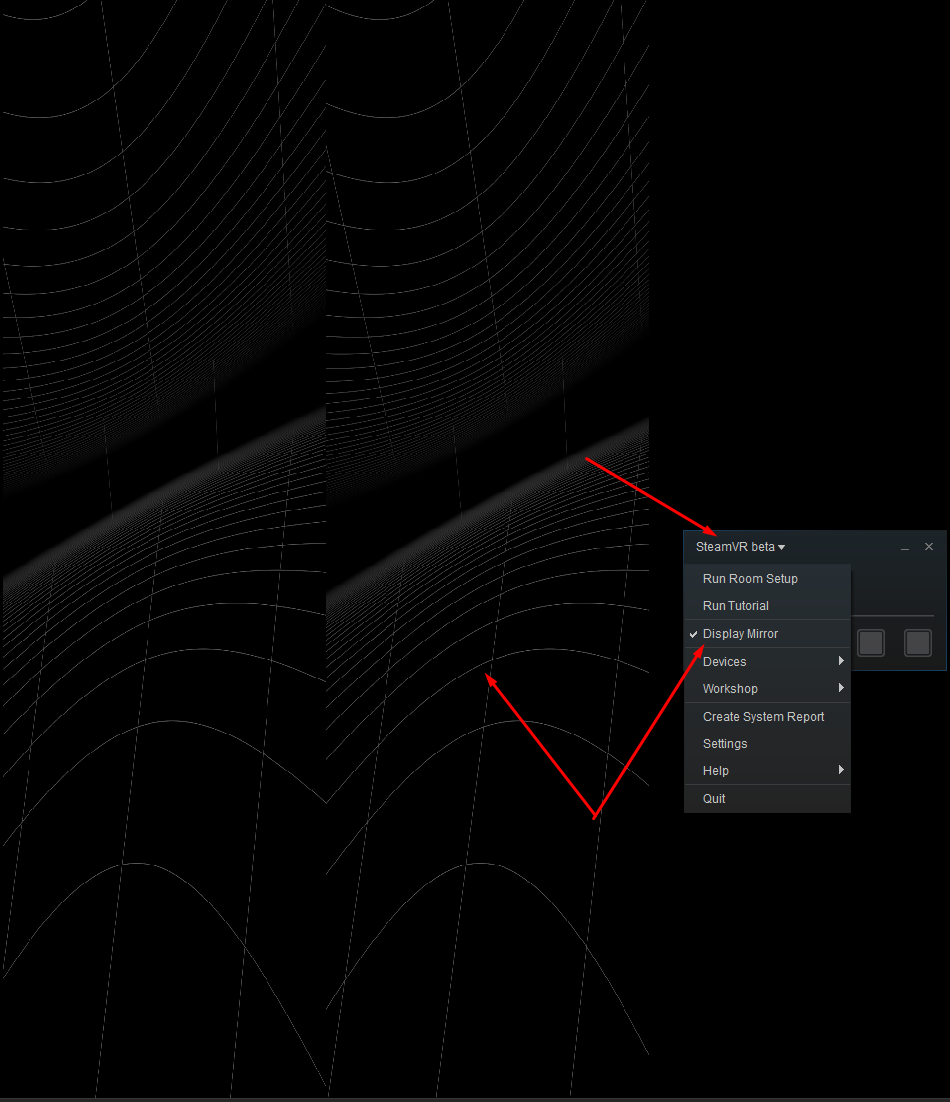

To find out if headset works or not you can run a display mirror and move your headset, if nothing appears in headset then there is definitely some issue and you will probably need to disable integrated video.

So tell us what is happening when you turn on window mirroring. Does the picture moves if you move your headset (on your monitor)? Is there any picture in headset?
When I turn on mirroring the picture on my monitor moves, but nothing is shown in the headset. It remains completely black. (no back light or anything)
Step by step: close steamvr, close pimax, open task manager, go to services, click “open services”, find piservicelauncher, stop, start, start pimax, start steamvr, mirror window. If still no picture - need to disabled integrated video, no other solution is possible i guess.
