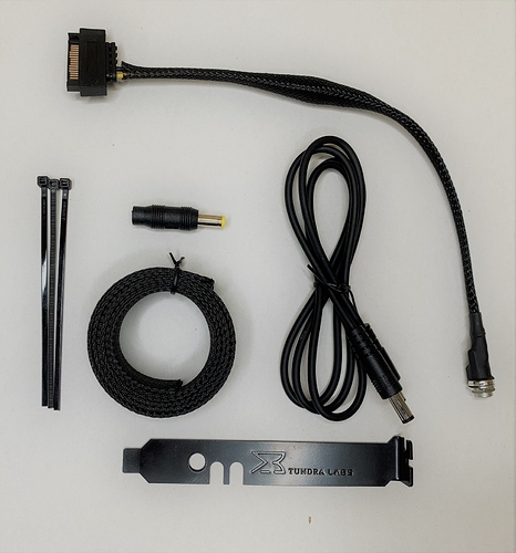

So apparently SATA is capable of delivering quite some Watts and this guy created a cable set to draw power from your SATA port and interface it with your Vive headset (Maybe Pimax too?)
Eliminating the need for a power socket connection and making your cable management a bit better too.
https://tundra-labs.com/shop/vr-dc-cable
According to him:
" SATA spec for 12V is 4.5A (54W) Vive consumes about 0.5A @ 12V (6W) "

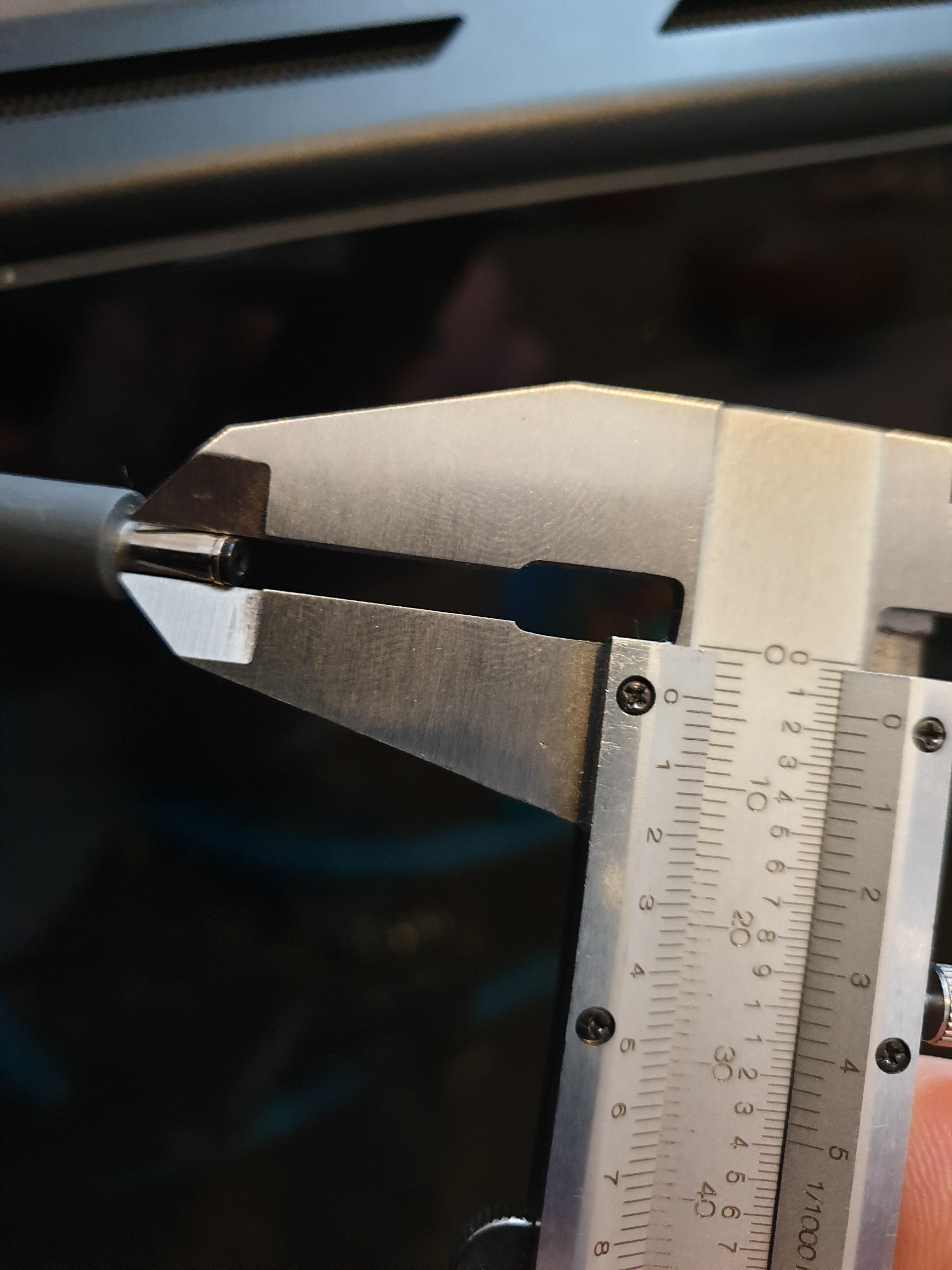

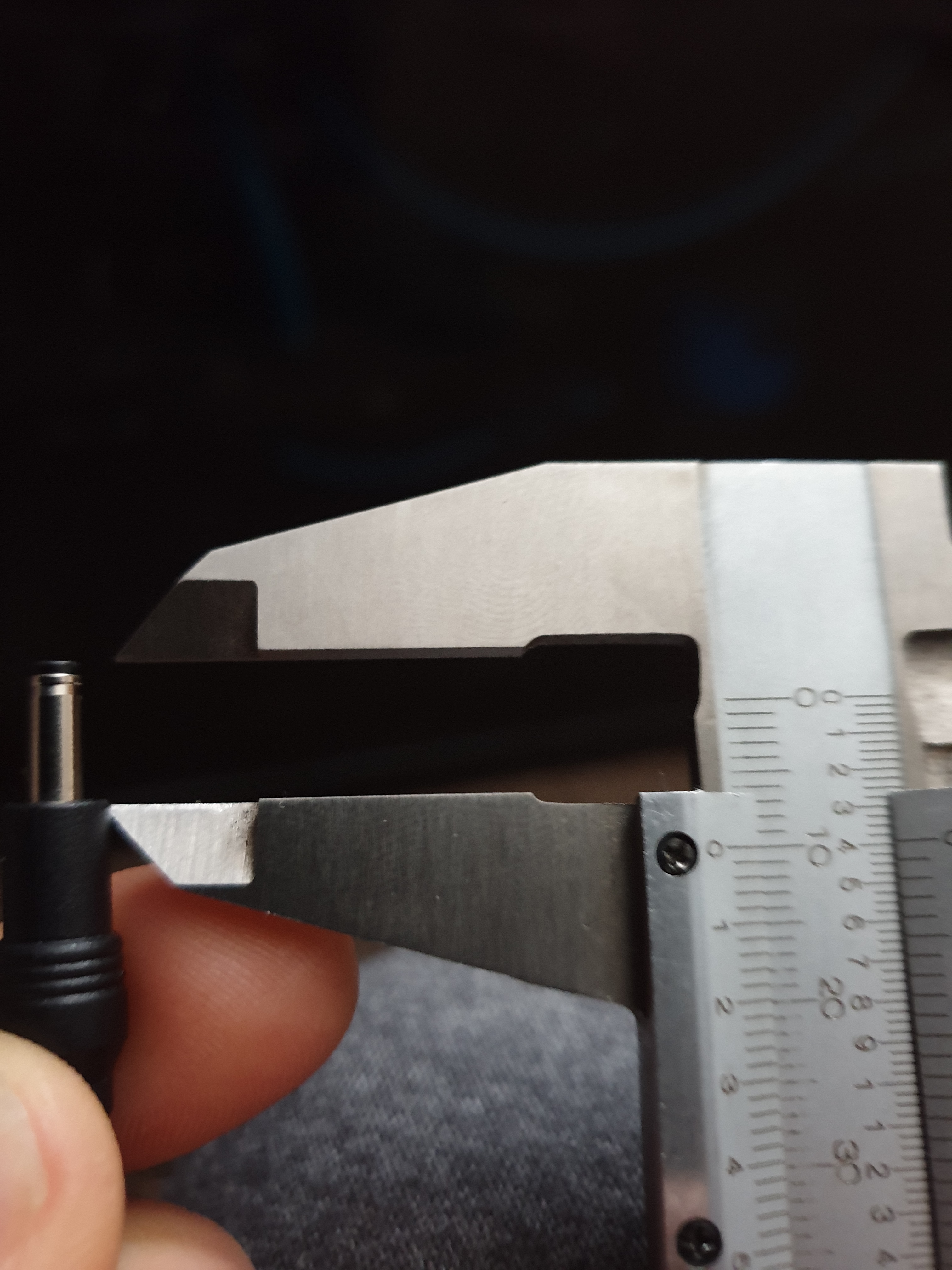

Right I just measured the vive 12v adapter & also tried it in the pimax & it doesn’t fit. It looks closer to 4mm
This would mean if you purchased this kit, you would need a different Male to Male 12v barrel adapter cable.
Even with the one from Amazon which @TrevorVR linked, we would need an adapter cable.
It seems Male to Male 12v in those sizes are hard to find, so would be easiest to solder a 3.5mm end on an existing one.

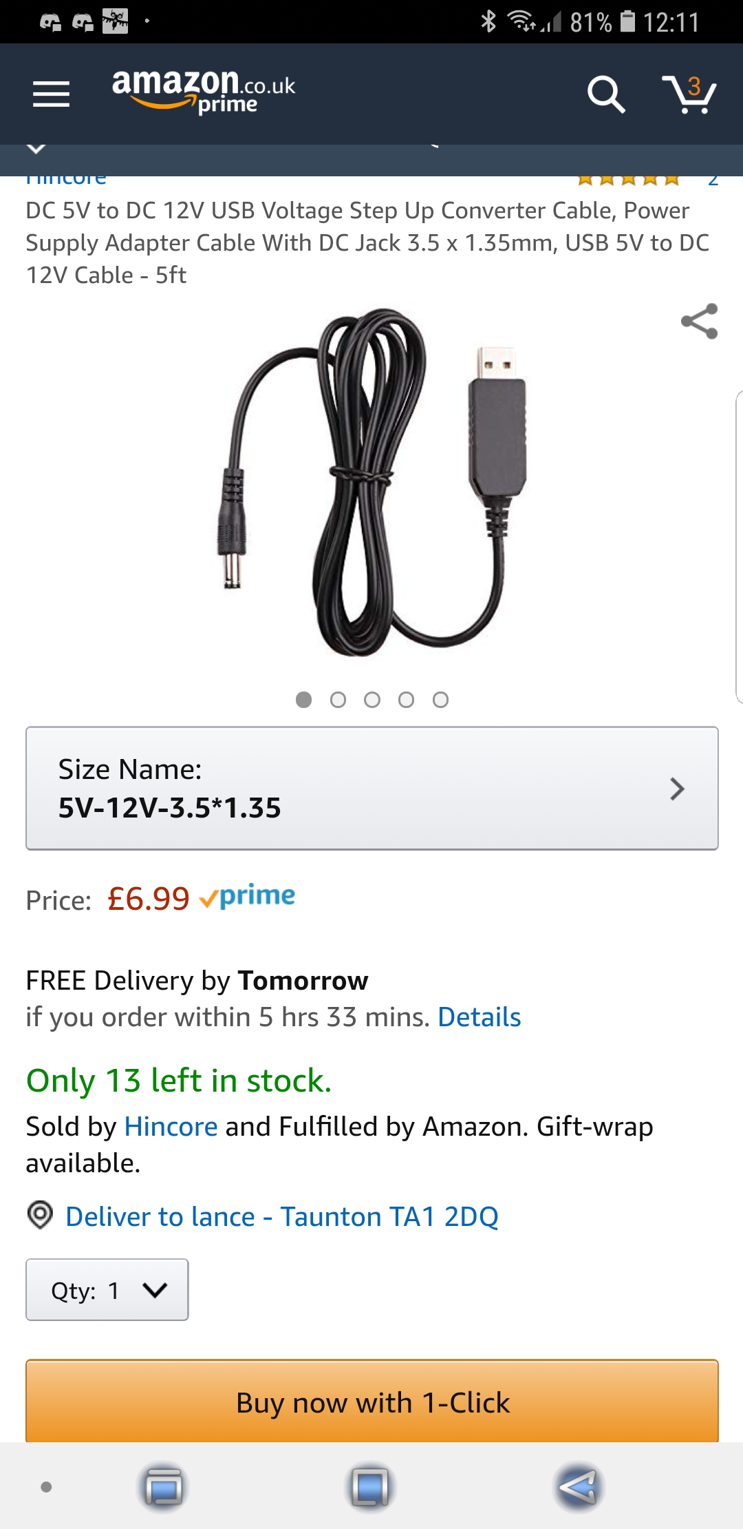

I found this usb 5v to dc 12v voltage step up which would have been so simple but unfortunately it only outputs 0.6a
I’m not actually sure how many amps the pimax draws, so it’s possible it may work but the supplied adapter is 2.0 amps so doubtful.

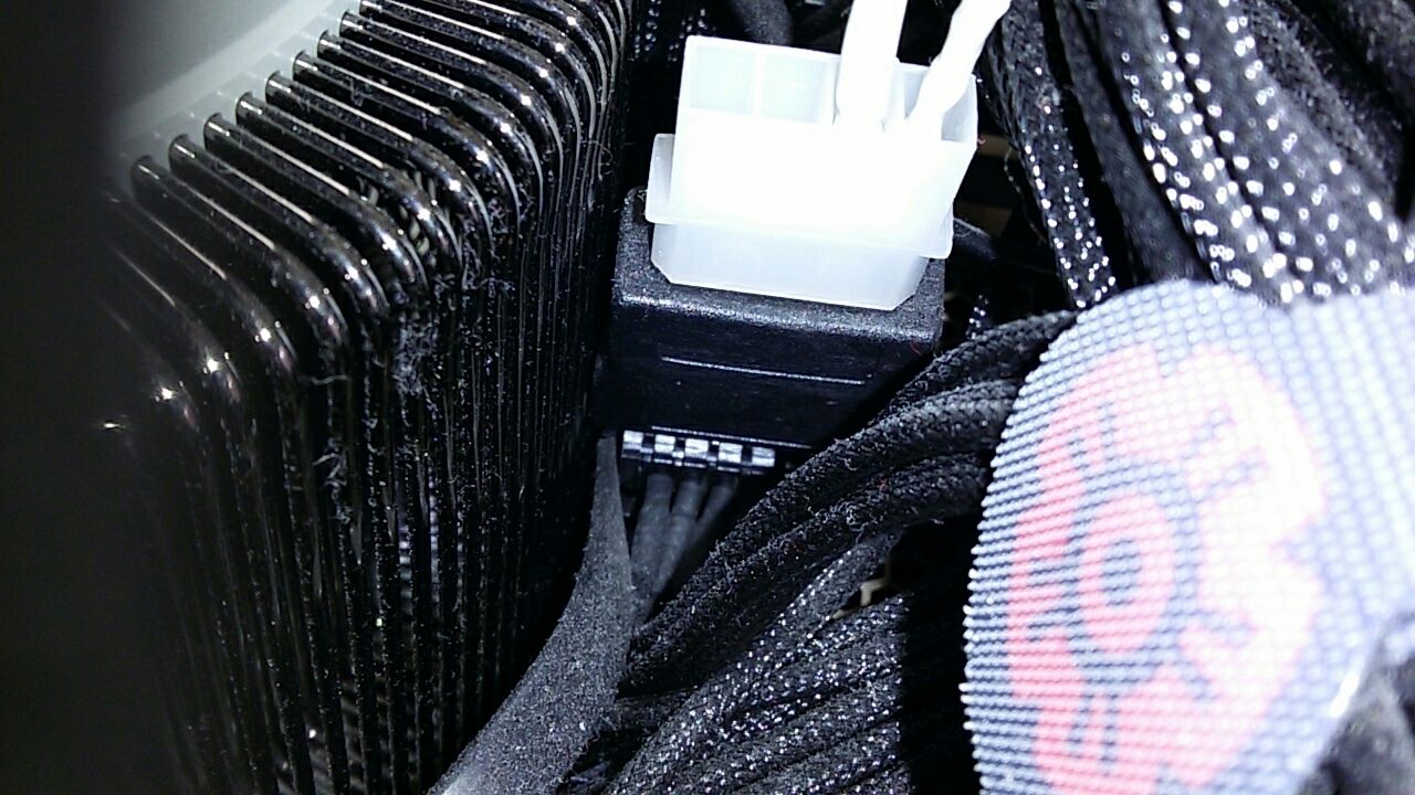

Here is what I’m using to power TPCast wifi adapter and antenna at once
So I’m sure it’s doable for Pimax no prob. Here I’m connecting to an unused sata power with a sata to molex adapter, then I bought the cheapest molex plug with cable and soldered it to a 5-2.1mm plug (most popular), which then goes to cctv power splitter, powering wifi, and for antenna I had to find a smaller plug so I used another adapter and some plug on cable I found elsewhere (didnt want to cut original cables). I’m only using 12V here but obviously you can use the other wires of molex for 5V as well.
