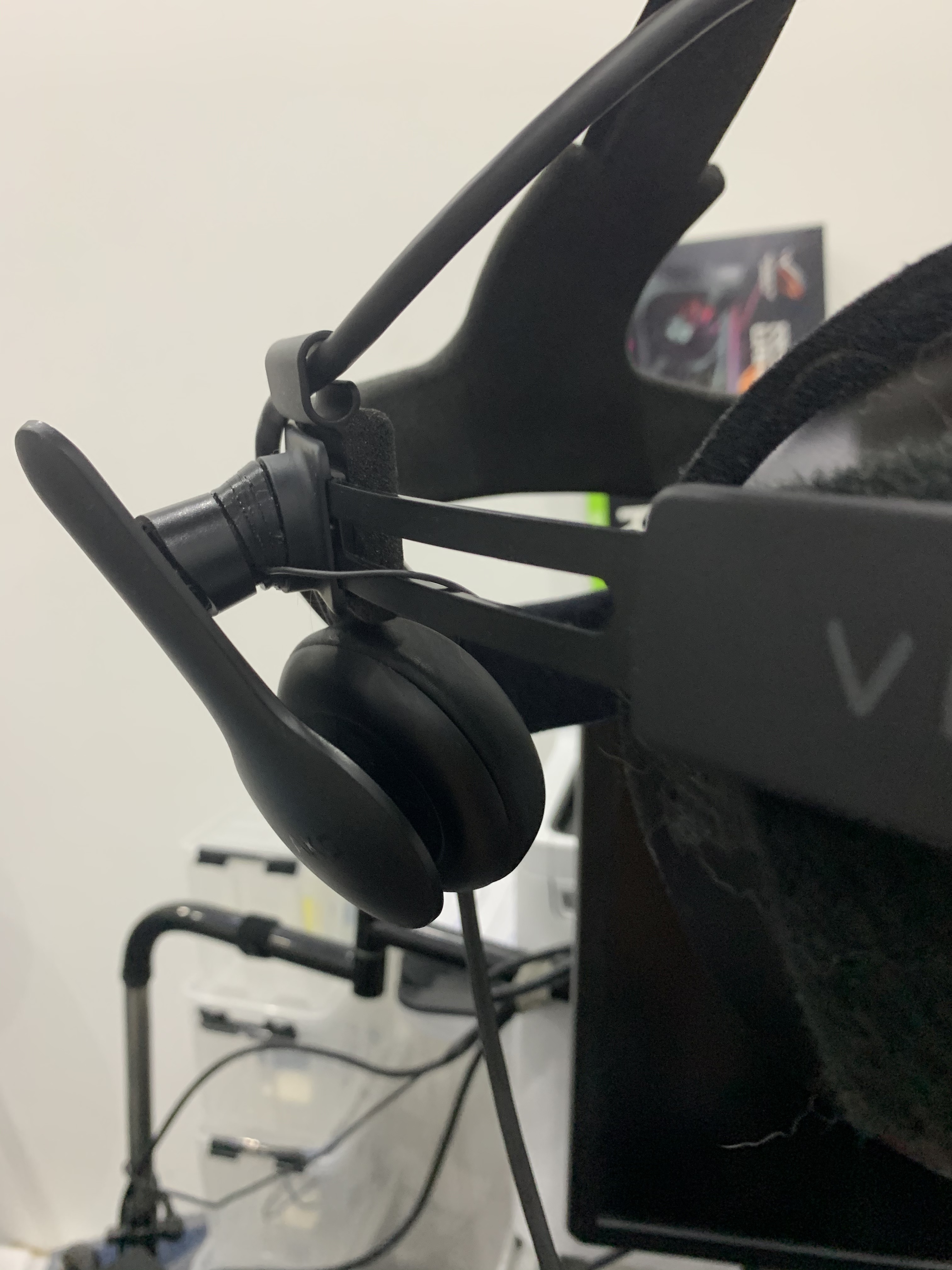

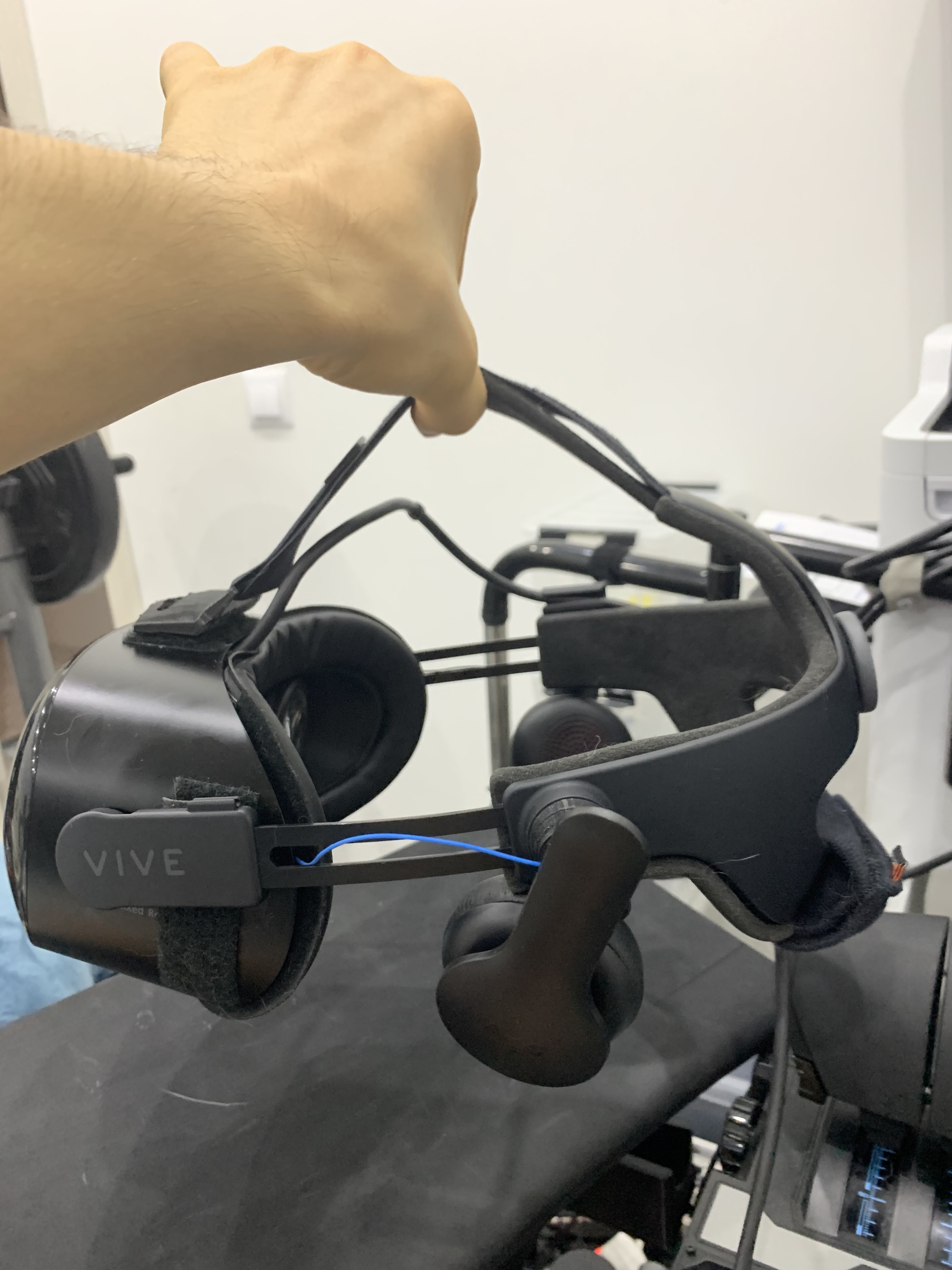

I used quick hack (it wasn’t quick as HMD disassembling process is quite long, lot of screws, clips, etc) I lost hope but in the end it turned out it was an amazing choice to try to do that, so here we have DAS adapted to Odyssey +:
Initially I used weak velcro & it didnt work, but this one from amazon did the trick: https://www.amazon.com/VELCRO-Brand-Industrial-Conditions-Professional/dp/B00JJPPNHM
I still have issue with top hook for strap it holds ok but detaches from the PLA clip once per 3/4 hrs if you tighten HMD strong, so I used it just as prove of concept from Pimax & plan to create another CAD that will be bolted to the HMD chassis
I have studio creation counter weight (received recently) & it works really well for this case as well, balanced HMD properly
Then I had hard time with cushion, I tried Oculus Q1 silicon bracket with Index VRCover thick cushion (sold only as packet with magnet bracket + thin cushion for Index)
And wow it was so comfort, I had to remove standard nose light leak protector as it hurts my nose but Q1 silicon nose protector works fine, it wobbles a lot & it’s not comfy to put HMD on/off but when you wear it, there is no any issues for me apart of small light leak between 2 brackets, I plan to CAD bracket what will imitate Q1 socket on one side & replicate Odyssey velcro form on another, so I can stick velcro on it, attach to HMD & from another side attach natively silicone Quest bracket, so it’s still in todo list
Well, then I like Samsung Odyssey+, I kinda find good Index audio, but for me it doesn’t work good, I constantly hit speakers & needs to readjust it, it sounds ok, but I wouldn’t say it’s incredible & find on ear speakers better, but index audio is better than DAS speakers, however I really like Odyssey+ speakers, they really comfy + sound much cleaner than DAS speakers and have good base, so I decided to keep speakers & made quick adapters that work perfectly fine for me & do correct pressure - not much to bother ears & not too less to loose basses & small details, it still has rotation & vertical adjustments of native AKG mount system + drivers itself have some degree of freedom to adapt to different ears form, so if you interested you can try on your own, but I didn’t upload to thingeverse, maybe later, don’t have much time now + it can be subjective approach, but it works great for me:

Update, finished top loop for HTC DAS head strap, bolted version, uploaded it here: Samsung Odyssey Plus HTC DAS Top Strap Adapter by pruban - Thingiverse
CAD link: Onshape
Not it sits firmly & I can tighten strap as strong as I need without any problems, I used self tapped screws) from the Samsung O+ screws which I have after disassembling. Works great for me, uploaded if somebody will try to mod O+ to HTC Das as well in future, some photos:
posted adapters on thingiverse: Samsung Odyssey Plus Audio To HTC DAS Adapter by pruban - Thingiverse
posting here for someone who will want to mod O+ with HTC DAS in future, I just finished top head strap adapter to mount HTC DAS with O+ in bolted version without any velcro, I kept mine from previous mod which detached from time to time, but it should work fine without any velcro buffer just with plain plastic, updated OP thread above in the end of it with photos + uploaded STL & CAD link:
CAD link: Onshape
