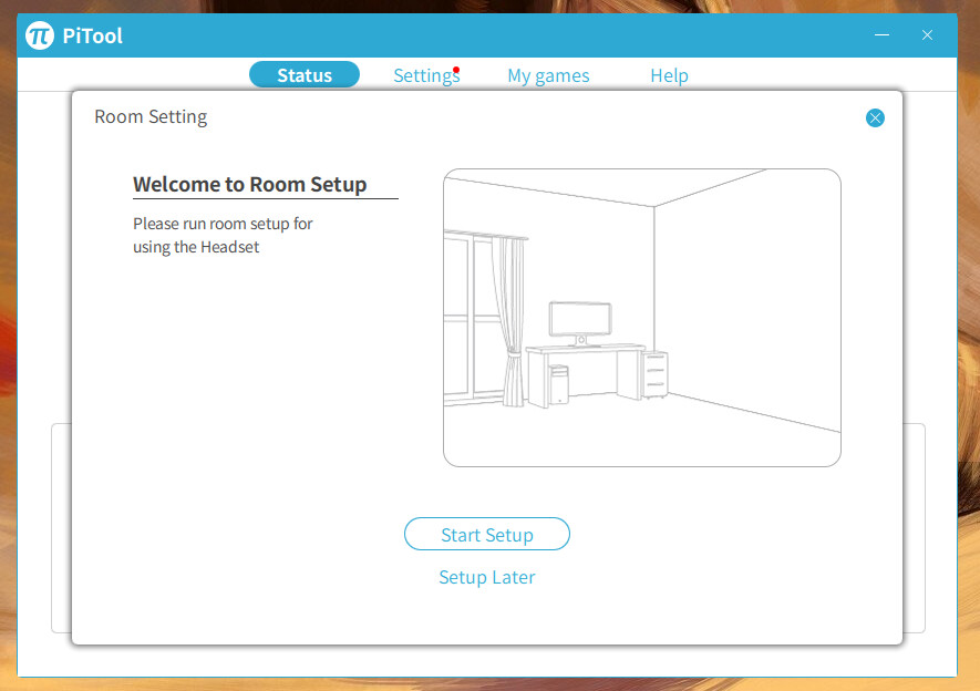

Hi.
i have an problem where i have to do room setup for both pitool and steamVR every single time restat pi tool or the pitool service…
and i can’t figure out why?
i’m running pitool V1.0.2.087 V2 and Experince v0.84 with an 8KX but have experienced this problem with previous versions of pitool. but not as frequent as now.
provirus i used an 5K+ on the same system and installation.
Pitool are running with admin rigth’s
i have tried to delete all files in the lighthouse folder and restart the service… but it do still not store the setup.
as long ar pitool are running steam VR seem to remeber it’s setup… but when ip service are restated it acts like it’s newly installed or it’s a brand ned HMD.
its the same if the pc are rebooted (ofc. as this will naturly reboot pi service also)
the next thing i have on my list are to try to make an clean install of windows and stat from there.
Hope that some one can give me an good hint.
My best guess is that it’s an issue with steam, seeing that it is a SteamVR configuration (the playspace) that is :wink:
You haven’t made Your SteamVR config read-only, have You? :slight_smile:
I’m only asking because some seem to think it’s a great idea to prevent SteamVR from updating the config (the GPUhorsepower values or whatever they’re called)… :slight_smile:
The strange thing are that both steamVR and the Pitool setup seem to reset… or at least the Pitool setup guide starts each time pitool start and then Steam VR are messed up too.
I have tried to simply skip the Pitool guide… but do not change any thing :frowning_face:
No i have not, and have double cheeked. And the strange thing are that Steam VR can remeber the setup and restart… but if i restart pitool or just the service it seem to reinitilize the room setup for both iptool and steamVR and both are messed up also if i skip the setup in piTool…
so i have to do this setup every day as i turn the PC off when i sleep to save power… i’m getting a bit tired of it by now…
