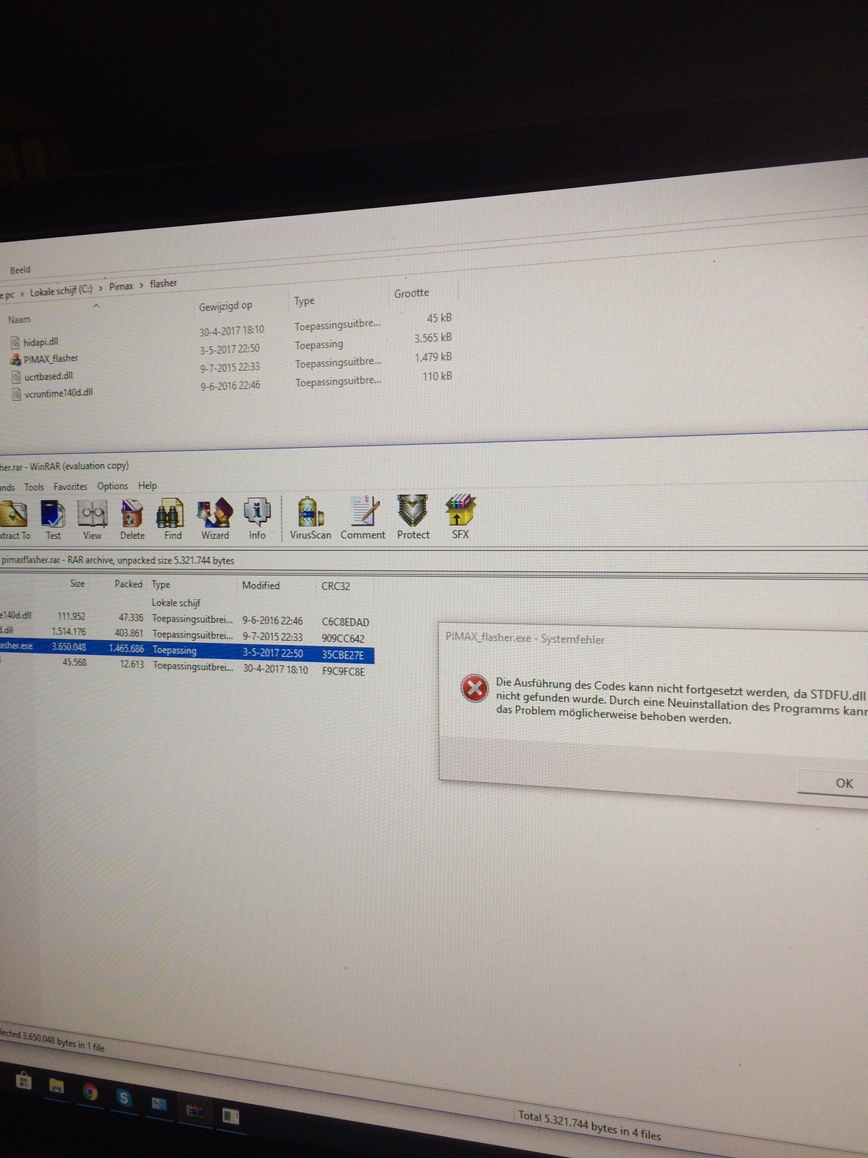

Found on the forums here about the manual firmware update and there i got stuck after unpacking the files where i try to open them it is missing dll’s

The led starts flashing like crazy the pc can than see the goggle but the program need to do the firmware update is missing the dll : STDFU…dll STDFUFILES.dll STDFUPRT.dll
Please can someone help me to get this problem solved?
