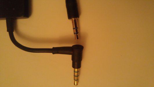

Can you post a pic of the plug you are inserting into the headset? Sounds almost like you are using a TRRS plug instead of a TRS plug…

Top is the TRS plug which had stereo for a limited amount of time and bottom a TRRS plug reference which I never used with the hmd.

Great, I have seen quite a few people using trrs plugs instead of the trs :). Wow another cracking case, PimaxUSA said it was a limited batch that were affected if I remember correctly… Yours must be one of them as well hopefully… otherwise maybe we can all expect cracking cases?
