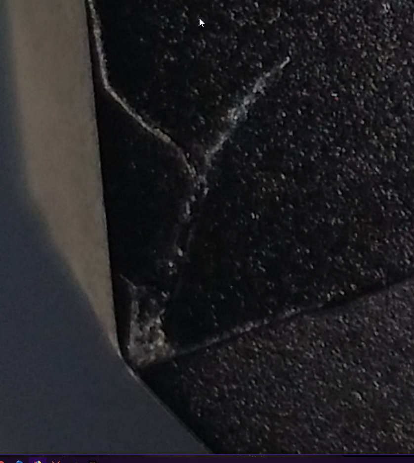

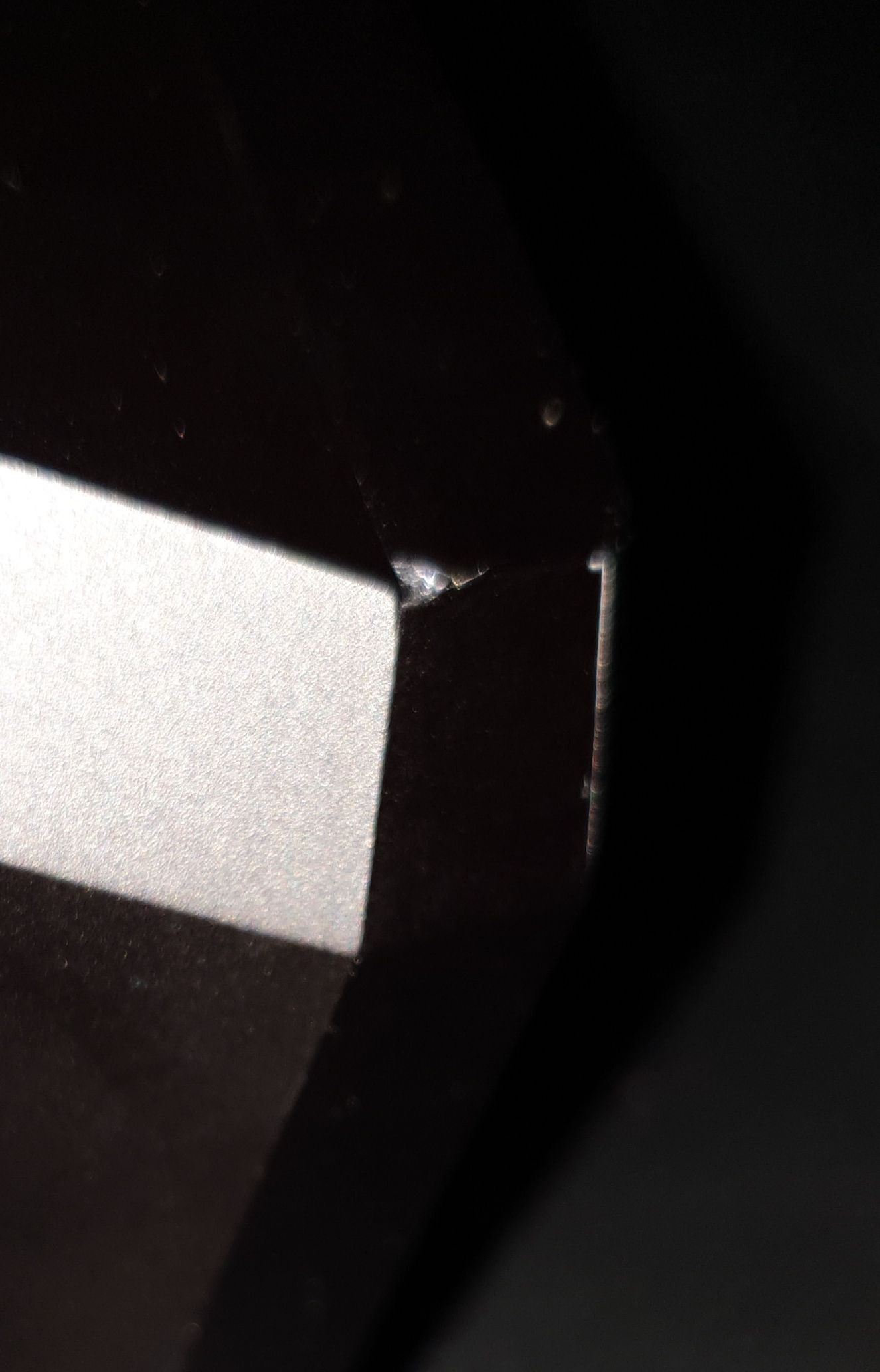

[Replied]O no my pimax 5kplus cracked!
Not good then if those were sent out to people. Also, I don’t doubt users here are also treating them “very gently” the cracking is caused by some other anomaly.
Yes, I think we should all be concerned but Pimax actually did address this issue. They did say they were aware of this situation and began an investigation and would work with everyone who has this issue to resolve it. Now that might not be everything we wanted to hear but they were not silent on this issue.
I imagine they are still evaluating this issue. I suspect part of the root cause is overtightening screws. But that may only be one component of a series of things causing it. Like mixed with thermal stress as well.

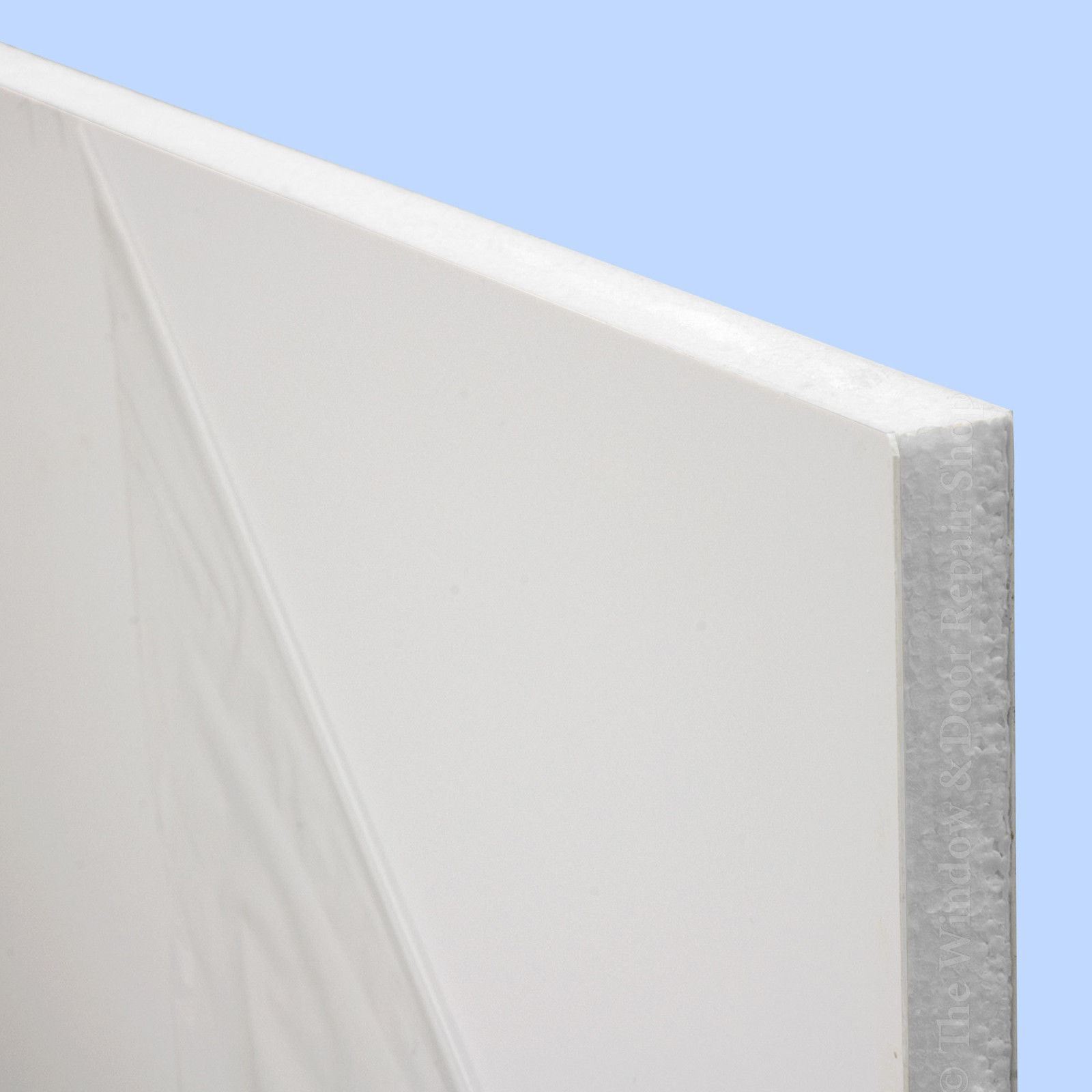

Is this foam sandwich between two pieces of plastic, looks a lot like foam filled plastic which would explain the light weight.
That is interesting. I have never seen such a material.
@anon74848233 backer 646 suspen 774
Never hit anything. I was only using my 5k+ sitting in my simrig.
So far so lucky. Though you’d think the 3 musketeers would have had a crack by now. Which to mean suggests more likely over tightening.

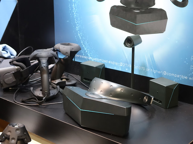

Screw torque may be an issue but that brittle plastic will not survive a controller slap anyway! No other headset has these sharp edges… for good reason.
Look at the prototype. It had rounded edges.

The m1 I beleive had the rounded edges & think the musketeers have hit the m2 with controllers.
