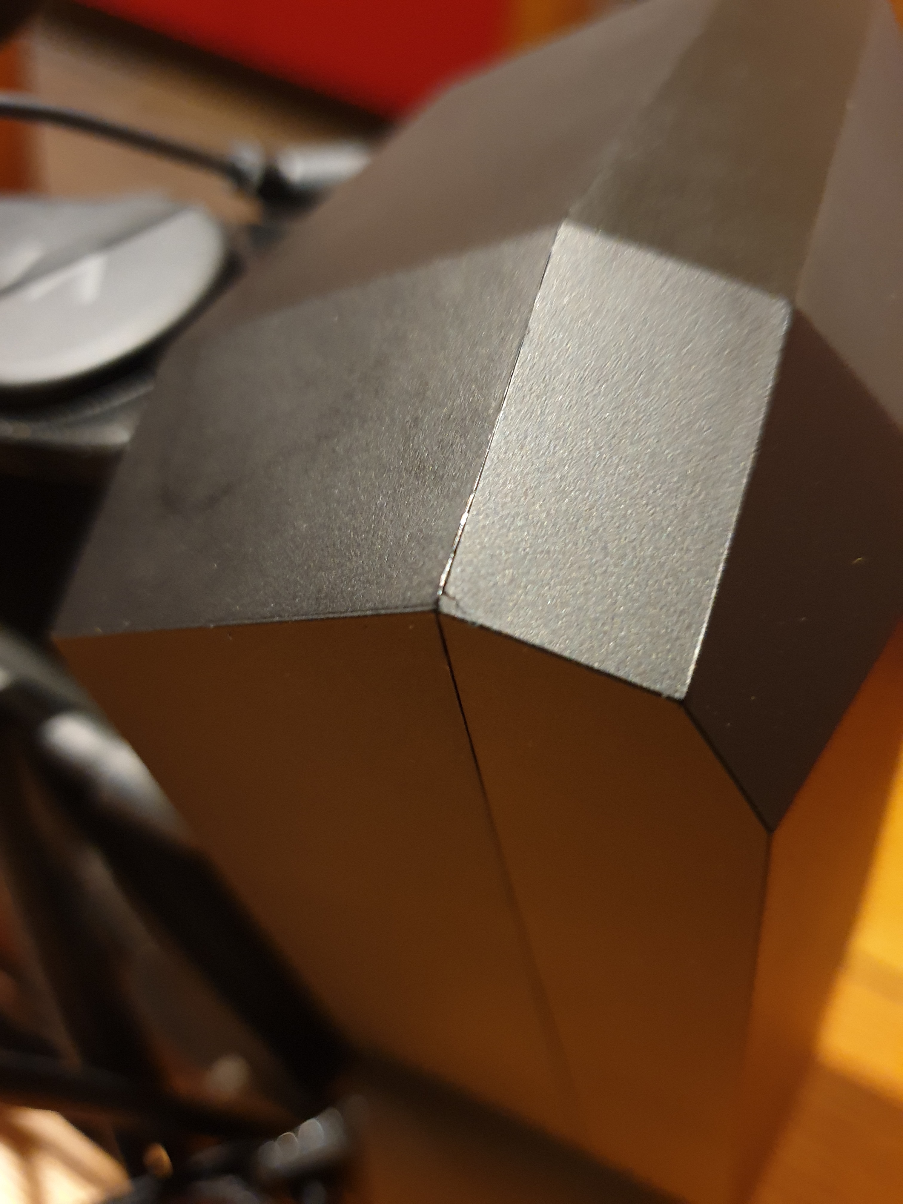

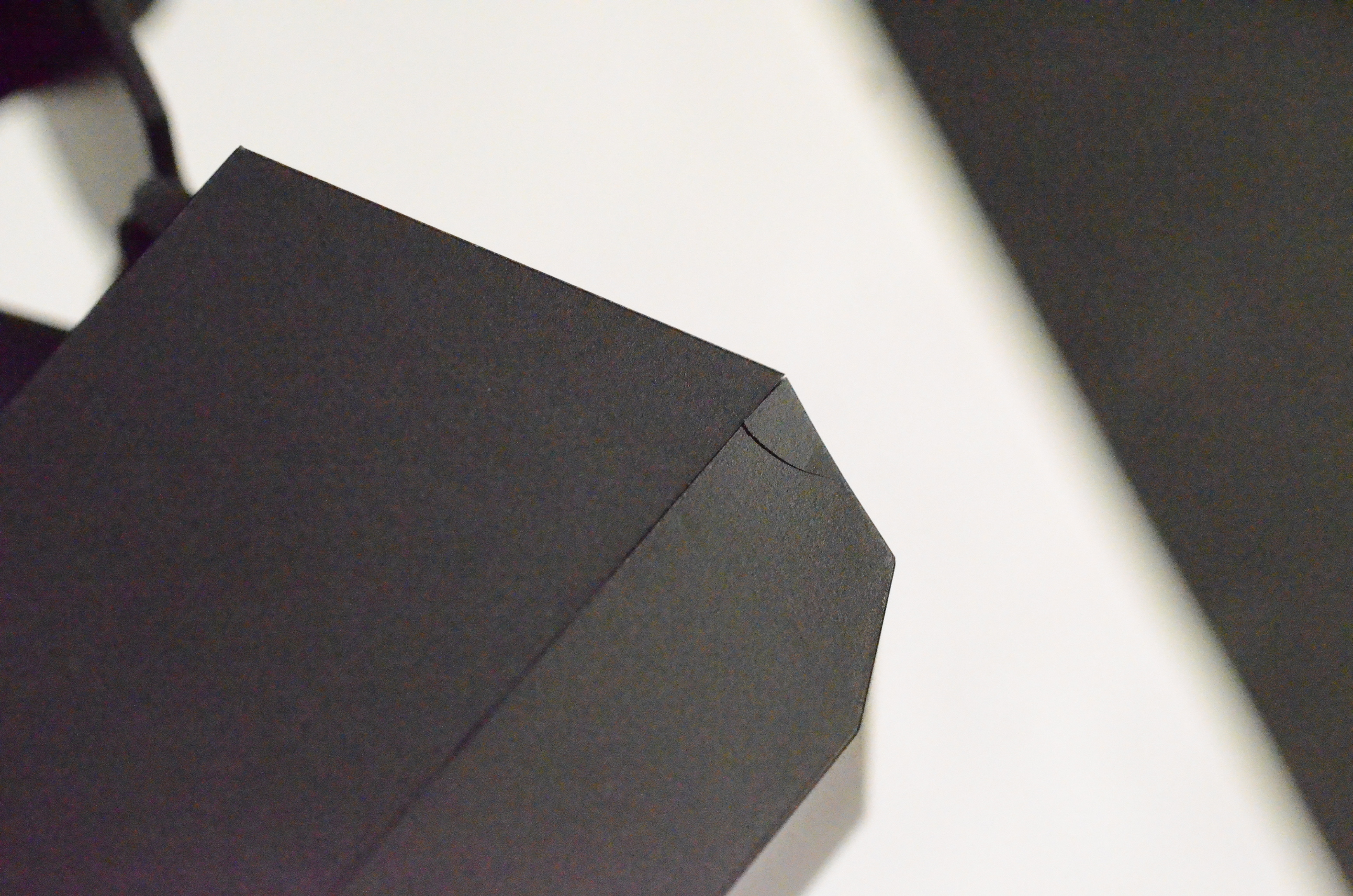

[Replied]O no my pimax 5kplus cracked!
I’d like to note I’m very careful in handling the helmet – I clarify this to exclude any suspicion of carelessness.
Also I would like to note that I use Pimax 8K rarely, I use more WMR Lenovo Explorer.
Today after I read this message I have decided to check my helmet and also have found some cracks. The cracks are on the left side of the helmet on top and in the bottom. Also please draw your attention to the fact that the plastic in the corners is very thin and the backlight shines through it. It is sad if the further controllers will be made of such plastic.
You can see your seems are stressed due to how they fit.

Other than op, all of these are about the same spot and look very similar.

An ever so slightly overtightened screw can cause enough stress to break stuff sometimes - especially given time. :7

Ok after reading this thread I can confirm mine is cracking on the corners.
I can also confirm that the pimax has had royal treatment.
It lives on top of my bookshelf when not in use & has had No drops or bangs other than normal picking up & putting down.
Also nobody else has used it apart from myself.
Although the cracking isn’t that bad, I can see it’s going to get worse with time.
I can only imagine what might happen if it takes a hit from a controller, or is actually dropped.

This issue is VERY FREAKIN concerning. I do not want a HMD that will crack with white glove treatment after a week or 2. I have several HMD’s all from 1st week launches, so a couple years use for them and NONE have any damage whatsoever. It just kills me that NO ONE at Pimax had the ability to see that the plastic and even the shell design was of poor quality and design. It is these simple things that just baffle me how they occur. How can they not see for themselves when they hold a competitors product in their hand how different it feels from their own. You can see how bad the plastic and quality of fit/design in pic after pic posted. Pimax wants a quality product I assume. Then they need to build it with quality. Who the hell with an interest in VR as the target audience of the Pimax line is, would be happy with shoddy materials and construction for a ‘premier’ headset.
C’mon Pimax Team. Demand better of yourselves. It feels good delivering quality. Try it! It also keeps you around longer and even if it costs a few cents more per unit to add that quality it can generate more revenue long term.
Indeed a inch pound torque driver would be a good idea if not already used to remove varience from one assembler to another.
