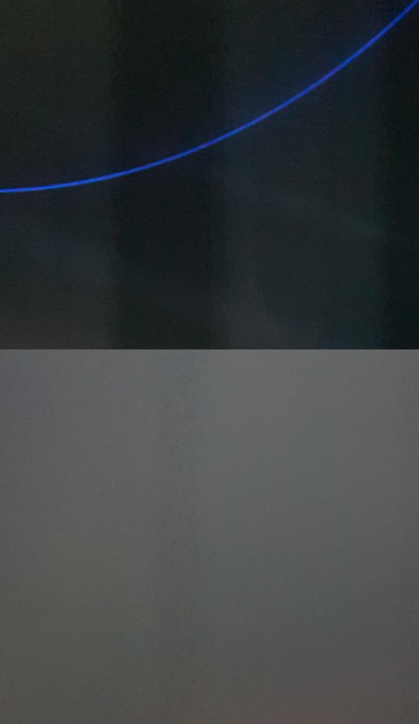

I made an image showing the problem.
Top image is beatsaber, bottom image is pitch black in Onward, both photographed through the lens on my 5k.
@IrregularProgramming
Hi, We have already tested it on Pimax 5K Plus/8K, the black level performed different from OLED, like what you have said it is covered with some gray in the beginning menu display. If you start to play the game, it will be normal display.
But compared with the OLED screen, you could also found that 5K Plus/8K could display more details on gaming display, e.g. in the beginning menu picture, pimax could see the tank by right side, but OLED not clear.
@Sean.Huang
Thank you for looking into this but I’m not sure what you mean?
I don’t compare against OLED, I compare the 5k against itself, Onward has a rendering problem in the Pimax headsets that other games do not have.
The image I posted above was 5k beat saber, vs 5k Onward blacks, if the blacks in Onward were as good as in beatsaber there would be no issue. I also played Contractors today on the 5k, it’s a huge difference. There is no screen limitation that makes Onward look this bad because the screen looks great in other very similar games.
This is a bug in the pimax driver that makes Onward behave badly.
Its not normal display in the game, everything is grey haze all the time, menu and in game.
Also your list of parralel projection games says onward is compatible but if you have this off there is loads of problems with objects popping in and out in the periphery, so you have to use the slow version.
