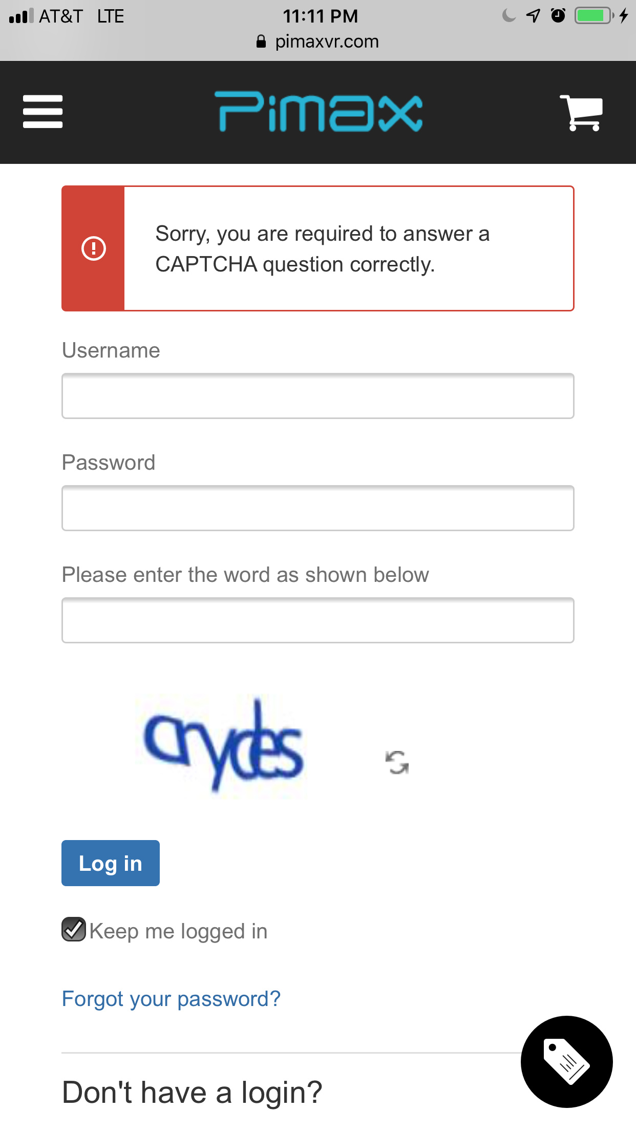

It keeps asking for a correct captcha over and over even when I put it in correctly. I can not access my support account to get a support number.
How can we resolve this?
