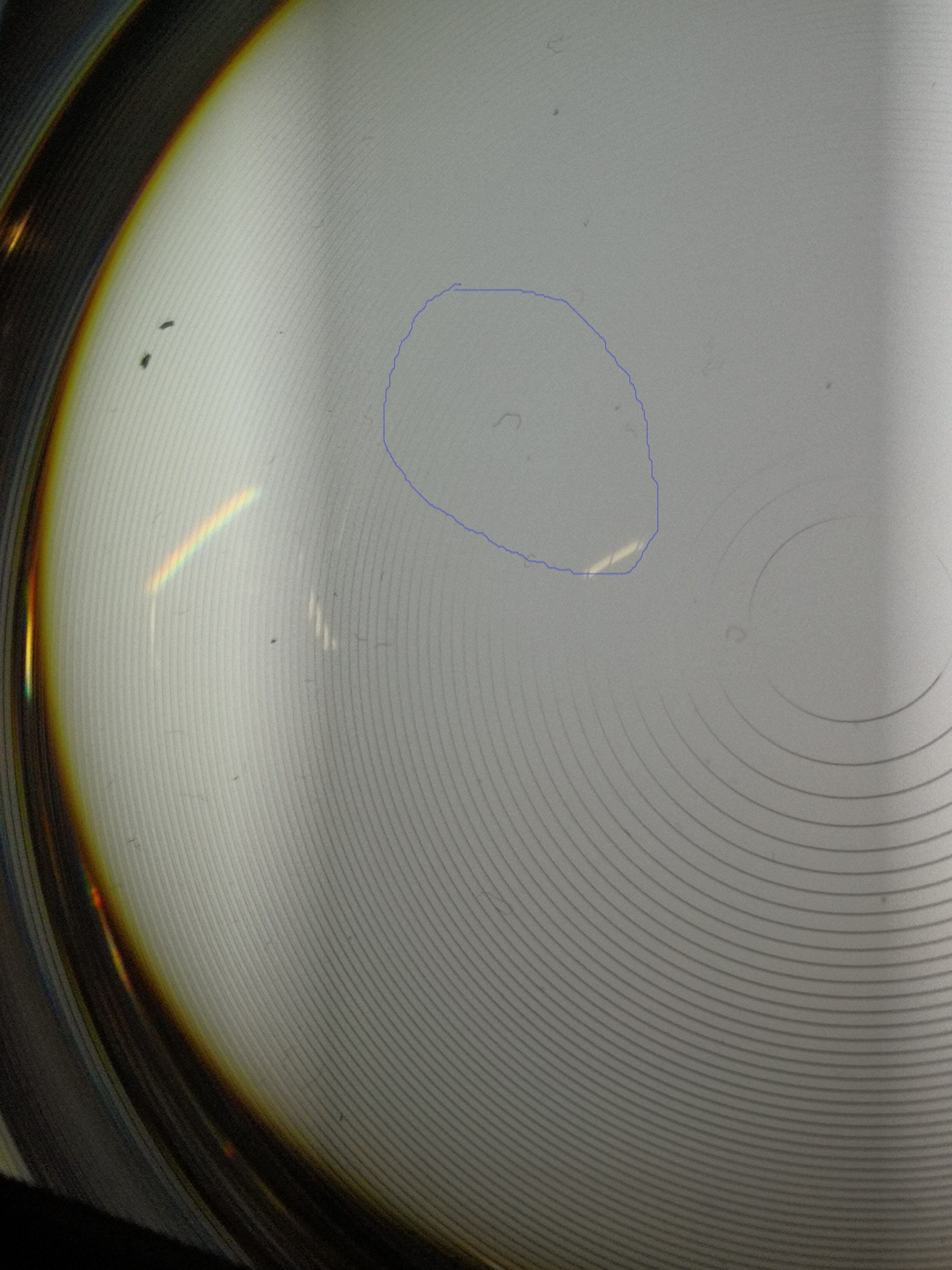

Received the 5K+ last evening and set it up today. There is debris within or on the front surfaces of both lenses as well as a rounded smudge within or on the front surface of the right lens. I promise that none of the debris or the smudge in the photographs are on the “eye/user/back” surfaces of the lenses and cannot be wiped off with a microfiber cloth. While using the HMD the rounded smudge is clearly visible near the 4 o’clock position of the right lens. In all honesty I cannot perceive the other debris while in VR, but I’m certain it shouldn’t be there.
RIGHT lens
LEFT lens

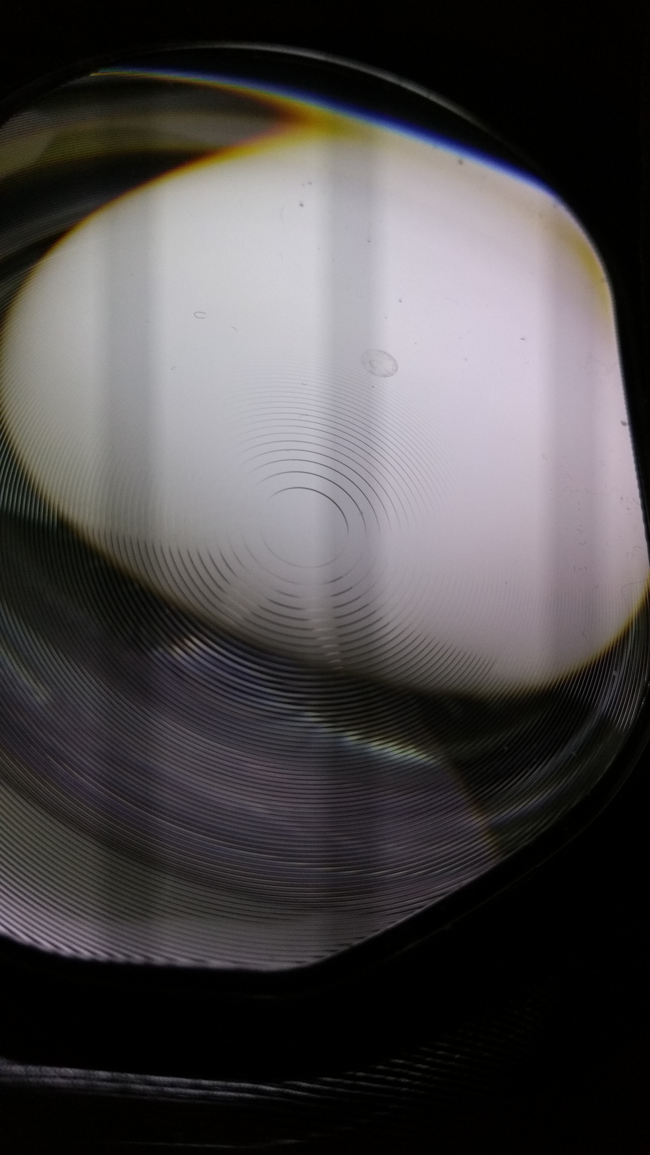

I received my Pimax 8k last Monday and set it up yesterday. My Pimax has the same issue. There is something like a dust or like a small steel wool wire between the left lense and the screen. It’s visible on brigth scenes.
Did you guys already receive a solution from the pimax support?
Attached are some pics. But as you all know, it’s kind a difficult to take a pic through the IMG_20190117_211816|375x500

Here is a pic.
Sorry, I didn’t know, that I am just allowed to upload one pic.

Support has acknowledged my ticket. I can live with the debris issue as it is not visible while in VR, but that rounded smudge results in a blurry spot in VR which is immediately apparent and distracting.
