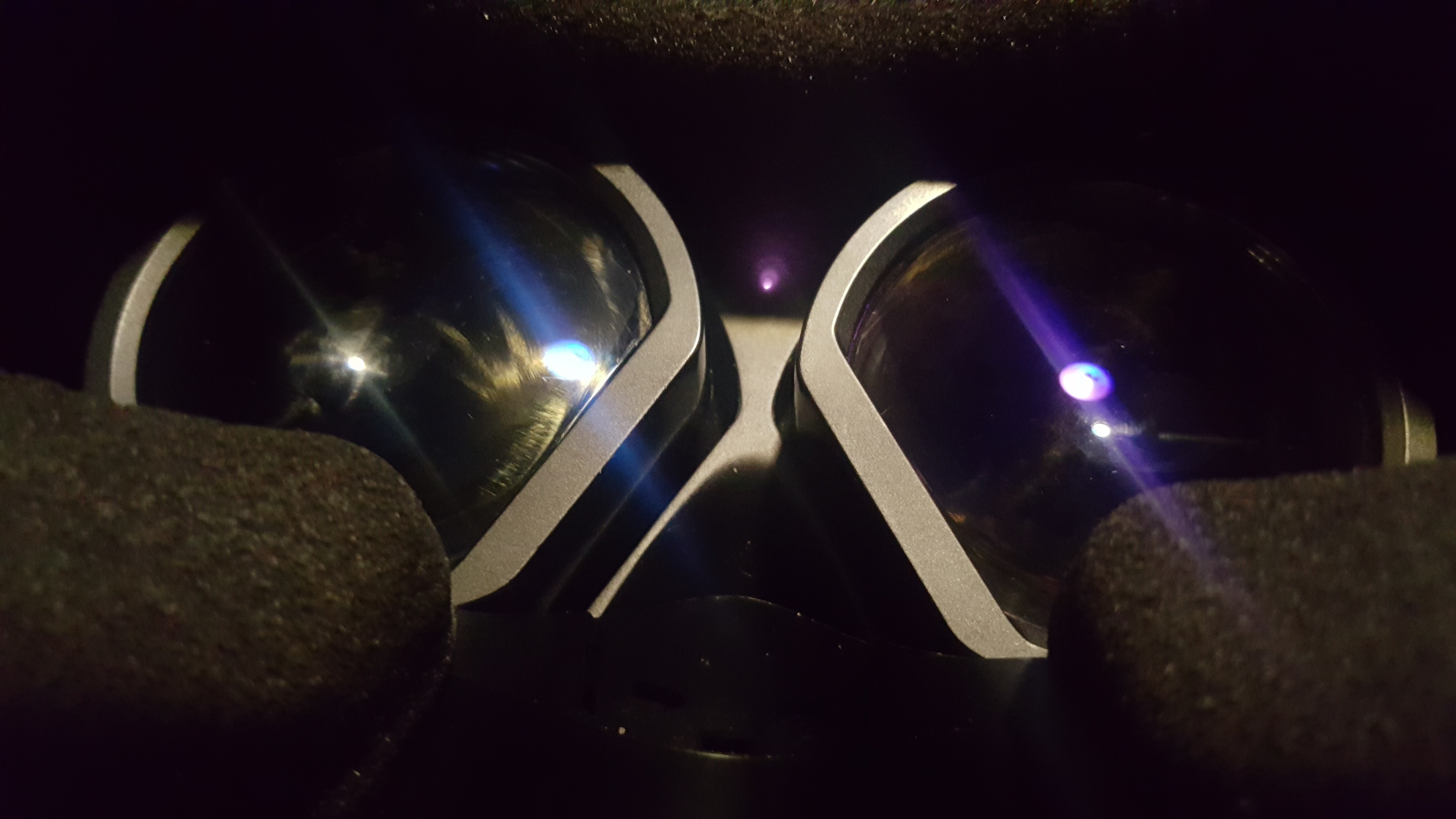

So stoked, popped out the vive lenses, kept the bracket on my replacement Pimax 4k lenses. Slid out the vive fov view to maximum. Squeezed the bracket over the vives lens holder (not a perfect fit but very close (sturdy enough). Tighten Fov lever both image quality and and holds the bracket.

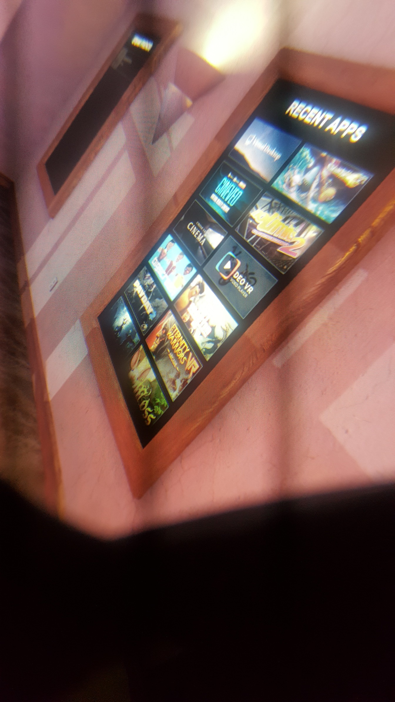

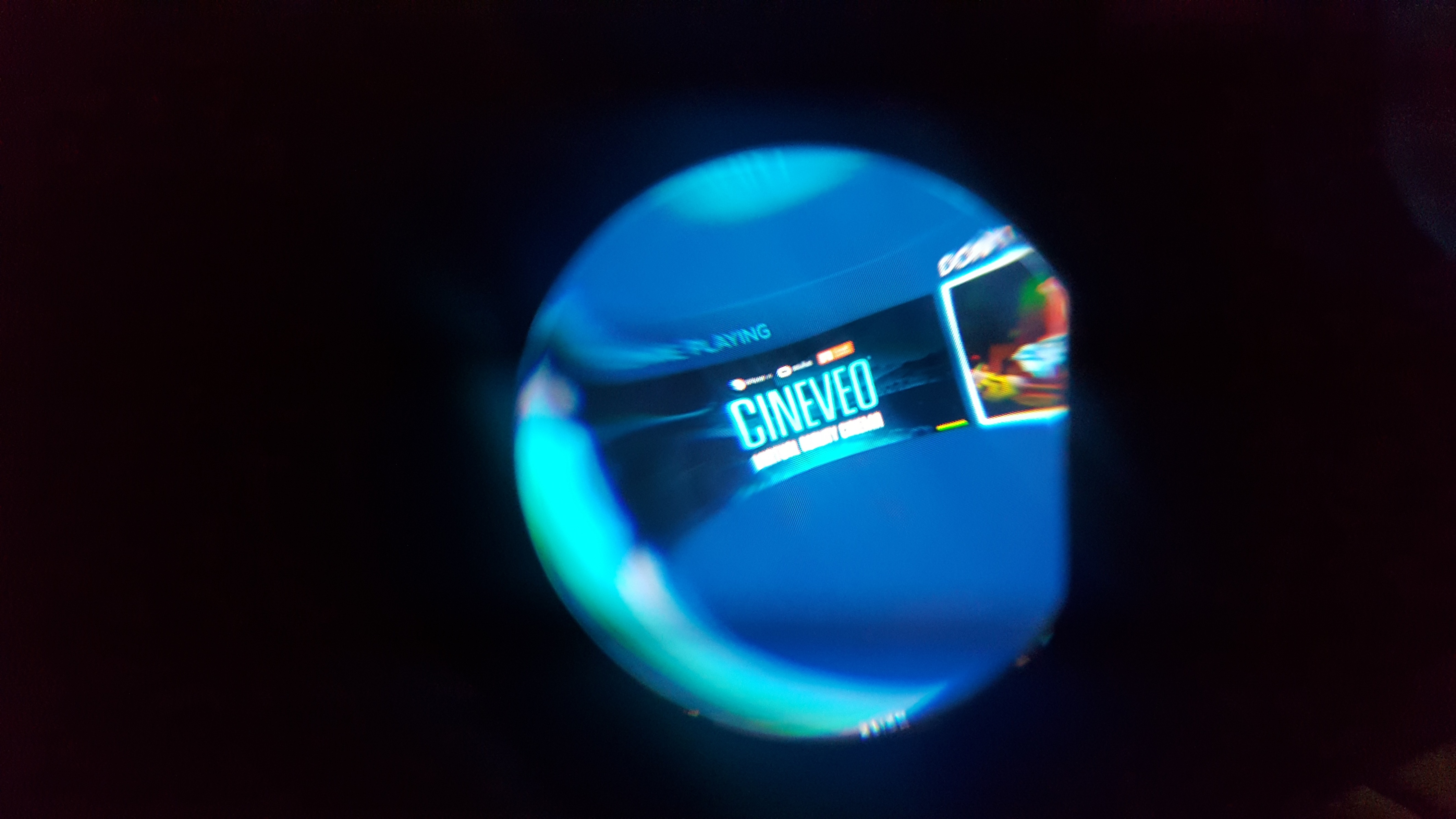

Needless to say. The image quality for me has improved an easy x2, Just that barrel distortion is keeping me from Jamming right now and will require a lot more Barrel Distortion uploads to the Vive tell I am completely satisfied.

The bracket is almost a perfect fit. They extrude a quite a bit. Image quality is amazing, the first barrel distortion file is way better then the third. Reading distance is greatly improved and clear ass funk. Will upload a small video, seems easy enough.

Some more pictures. Did not want to pop the lens bracket off, cleaning the dust takes a good ten minites after.

Brilliant. If I had a the 2012 GearVR, I would have used those lenses. I do not. The only clear lenses I had were these extra Pimax pair I got from Pimax. I was just posting in Pimax because their bracket is almost a perfect fit.
Yeah no god rays, sweet spot is huge, clarity is amze bollocks and FOV is like being an apex predator. Which means a lot more barrel distortion settings til I get it right.
So, so, so freckin happy. Clarity is an easy x2 clearer.

Main things are good with these lenses. I don not see the screen edges, picture is clear. A plus minus is the lenses bracket extruding. It is quite close to my eyes but immersion is something else.
So findings after two days of tests. Without the correct barrel distortion and the weight of the lenses. Htc Vives Fresnel lens win out.
Less clear and god rays are a downer but gather fresnel are needed to keep the weight down.

I actually went back to the default Vive lens settings, without Barrel distortion and removed the three screw clips on the side of the Pimax lens holders. Slip the cover (snug fit) over the entire Vive lens bracket.
Clear image with very slight distortion. i am very happy with it now, revisiting all my old games in awe of how much better the picture quality is.
