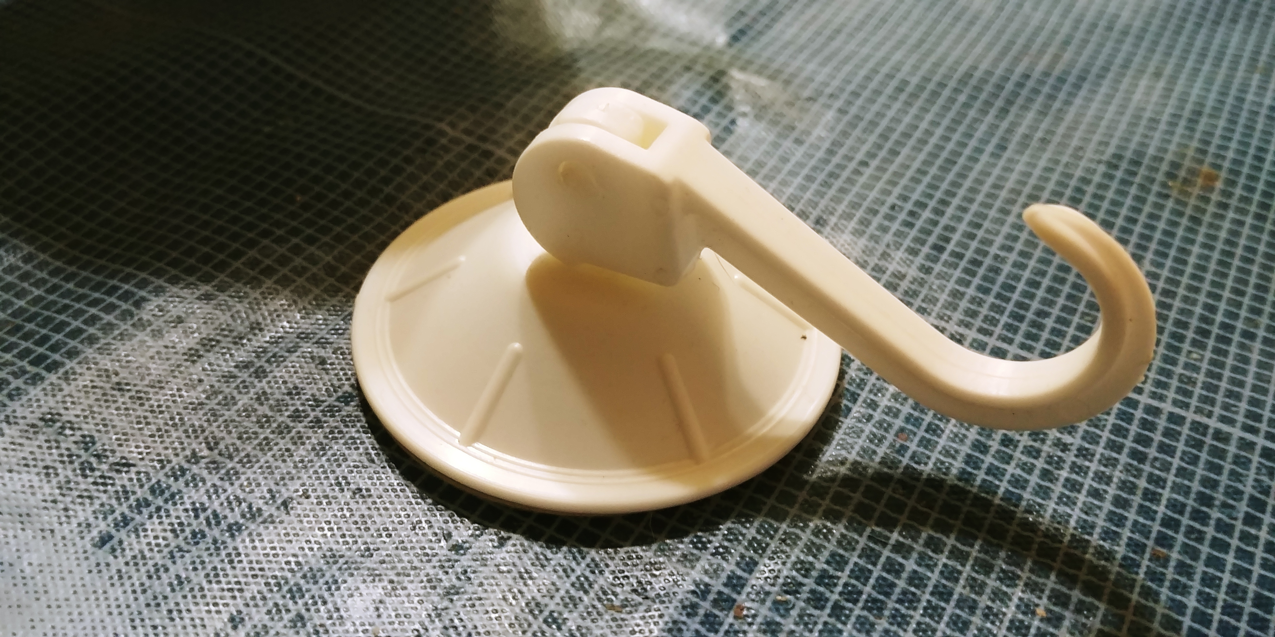

Nothing Special. It’s one that suctions to a wall to hang things. But will take a bit of force. With new lenses you will likely need a couple of small dabs of thin black silicone or a couple of narrow double sided tape if lenses have no adhesive.

Get something thin like a knife, gently lift one edge while pulling with the suction cup, once it starts to free up with the knife at the edge it will come out with just the suction cup.
Huge thanks to everyone in this thread – I was able to successfully pop off my lenses with ease given some help from Heliosurge… it’s actually surprisingly easy once I figured out where to place it + how to brace the headset / what force to expect.
The trick for me was place it near the inside edge of the lens, wrap a cord around the hook, press at the back of the lens and brace the headset at the same time.
Then they just pop cleanly off – and they slide right into place without adhesive (at least for me) due to some of the surrounding plastic / rubber.
Which then allowed me to swap my XR lenses with my + lenses, no hiccups… so while I wait for my replacement lenses I can still use both headsets perfectly.
Super stoked that after almost 3 weeks I can finally get into my XR!
My bad should have mentioned I placed suction cup at inner part of lense near nose.
