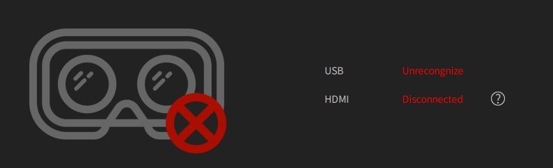

I did that and the LED on the headset now flashibg white with a little bit of red. When i start PiPlay it says that headset is disconnected and device show USB not recognize.

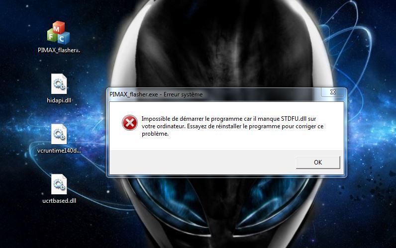

Try it and still not working, i got a message saying that STDFU.dll is missing
Please help!
If you want, I have the original Pimax Flasher tool for Pimax Serial 100xxxx
Klick here for download. In this file you have 3 firmware files included.
It seem my computer missing STDFU.dll , can you look in your system to see if this dll is under system32
I’m using Windows 7 pro sp1 x64 version
Check your piplay directory with search function. If you have a directory with that file try putting dfu tool in that directory & try launching.

Tried it and now it does not say’s missing dll but application won’t start anyway. Is application should open even if hansdet missindg or defective?
