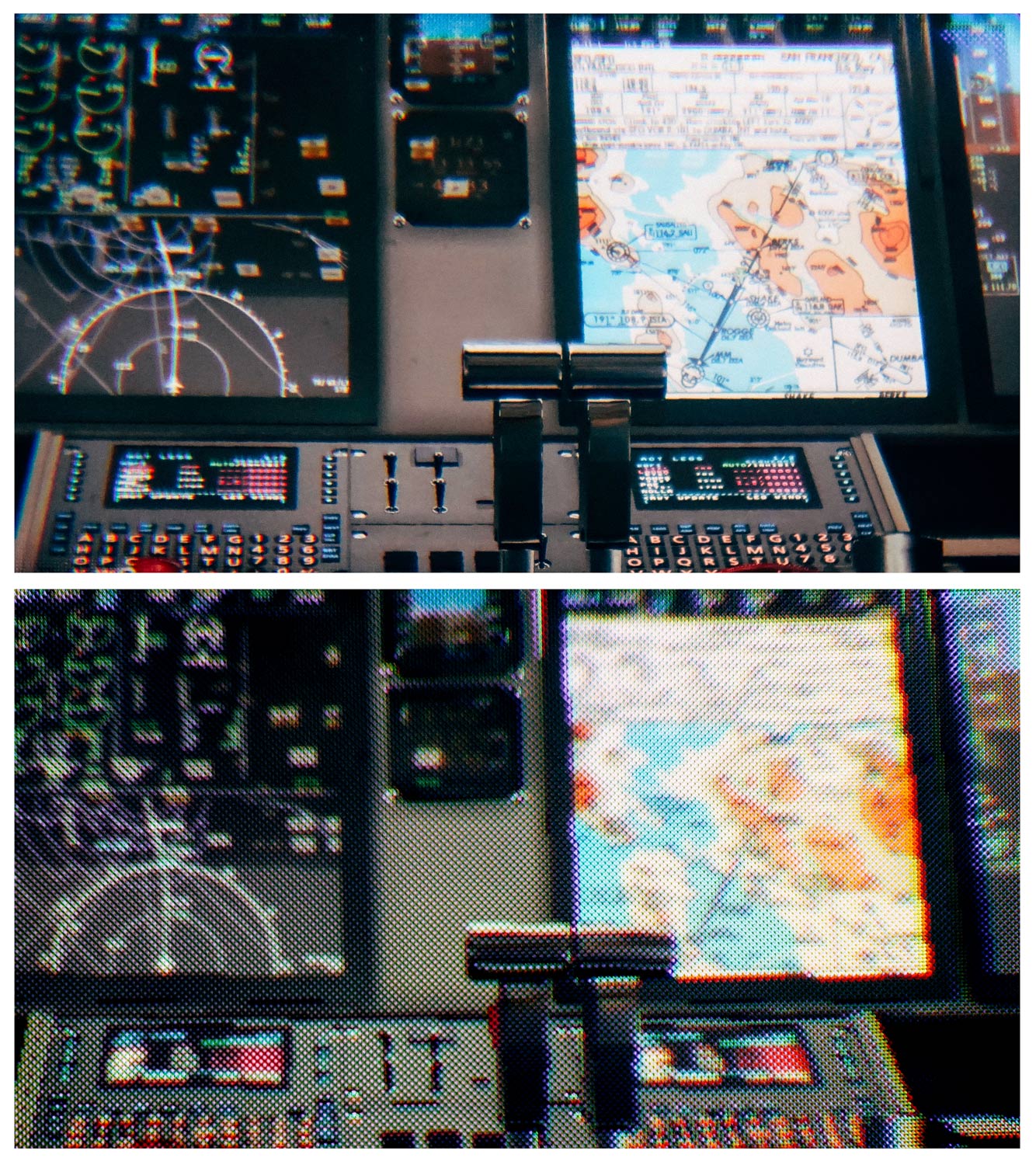

Varjo projects two small images from Sony Microled 0,7” 1920 x 1080 panels, on the focused spots (with eye tracking) of two standard Oculus Rift 1080 x 1200 panels, to accomplish human retinal resolution in all the headset FOV, in the prototype case, a Oculus Rift, 110º.

Have you seen the screen shots of the Varjo prototype ? I can see that this may make sense for certain commercial applications, where function is all what counts, but it was pretty ugly if you imagine this to be worked into a VR HMD for playing games etc… You would have a box with awesome resolution, and then a brutal cut to standard resolution outside this box.
Hard to imagine you can develop any proper immersion with that sort of falling-of-a-cliff experience in terms of resolution.
The major difference here is, with foveated rendering you see full resolution anywhere on the screen, whatever point of the display your eyes are gazing at; even if it is on the edge of the display. With the Varjo you will be looking at high res if looking down the middle, but as soon as you leave it a bit more, suddenly you see a clear line where the resolution drops significantly.
No, wherever you look, it’s retinal resolution. It’s a Oculus Rift with retinal resolution.

As far as I understood it, and just checked an article of RoadtoVR from the time, they suggest to have their high-res display in the center of the view for the 70x super-duper resolution, but then around it you would have a traditional VR display to get a proper FOV, and that would then only come at say 1x, 2x or 4x resolution. So you will inevitably get a border where the resolution drops dramatically:
“Varjo however claims an effective resolution that’s nearly 70 times greater than today’s headsets. They’re doing so with an interesting display layout which combines typical VR displays with higher density micro-displays to make part of the image hyper-sharp. The company says that portion of the image achieves retinal resolution, meaning that the pixel density is so great that you can’t tell individual pixels apart.”
