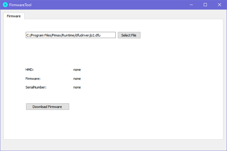

you need to manualy flash the firmware.
So in summary the firmware is bug (when you connected it the first time it must have tried to update and had an error ?!)
so in the pitool installation folder opens DFU.exe
C: \ Program Files \ Pimax \ Runtime \ Dfu.exe
in the application select
C: \ Program Files \ Pimax \ Runtime \ dfudriver \ P2.dfu
then Download the firmware.

hello guys,
I have the exact same issue. My LED is blinking red green and blue all the time and pitool gives me 10500 error message (usb not connected, dp not connected).
I am trying to click on “download firmware” but it wont do anything?
Hi Conan76,
Please kindly help us confirm if you unplug all cables(DP+USB+power adapter), after some seconds plug all cables and connect it .
Then Please help share us what is the result, it could be recoverd or just the same result(right lens crashing and turning off)?
Tkx a lot
