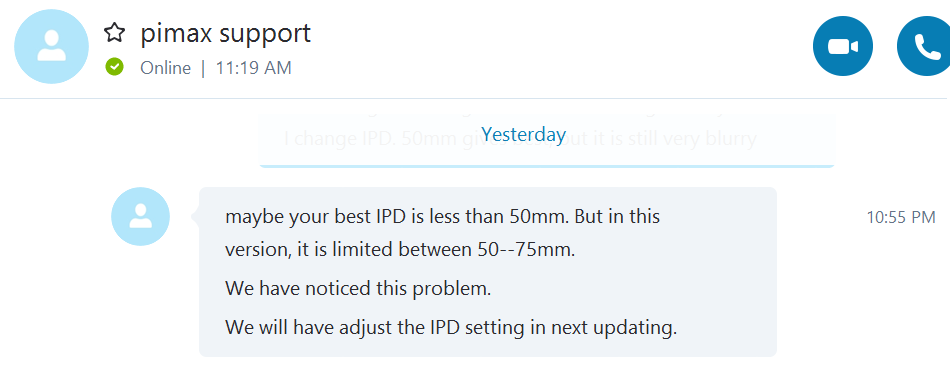

I have been in contact with support team via skype for 3 days now. I am afraid but if I don’t come across workable solution, I will look for the ways to receive replacement unit.

IPD settings are working - I set it at 62mm for my eyes, but image is not clear cos there is a vibration.
I change it to 50mm like someone suggested in the forum. I have a link below:
http://community.openmr.ai/t/best-ipd-to-use/380/13
If you think about it is odd, that I see best image at 50mm, when it is clearly not my Inter pupillary distance - I think it is what it stands for. But 50mm is not even that clear - it’s sort of best among all blurry images, unfortunately…
It looks like development team is releasing new patch to improve IPD settings!!!
I am so excited about it. I like the design and high resolution my headset provides. I am afraid but I will have to work with PIMAX SDK until it arrives… :slight_smile:

I truly hope that they release the patch to allow me to set IPD in bigger range. I am afraid at this point, I am no longer going to use PIMAX because image is too blurry;;
I do not know whether new patch will come, but as of now, this product is certainly unusable. I will just have to cross my fingers and wait, or;; try to get this working somehow - as we both know, this product is largely a big failure… lol But the support team do seem to be updating software, and last update on PiPlay - it seems to me - came at around September 19, which is like a month and half ago. I can wait this long, given that there will be a major software upgrade not only to address health risk - that I am reporting - but also in SteamVR/ Oculus Rift compatibility among many and many problems that you can find in this forum.
Hi mytemplo! Haha thanks for the kind explanation on IPD but I already knew what they are;; Now, I am sure you and I both understand how bizzare a person would look when his/her IPD is less than 50mm. I do have IPD of 63mm and I need this product to give me comfortable images for my eyes like any other VR goggles would do.
My problem with PIMAX - that I would like to get attention on - is the fact that product does not give me comfortable image at my true IPD which is 63mm. What is even more bizzare - in my opinion, is that image actually looks better at 50mm - but it is very eye tiring. Whether new patch will come - I do not know - but I really need some changes to PiPlay or other back-end software supports because, this product is unusable.
