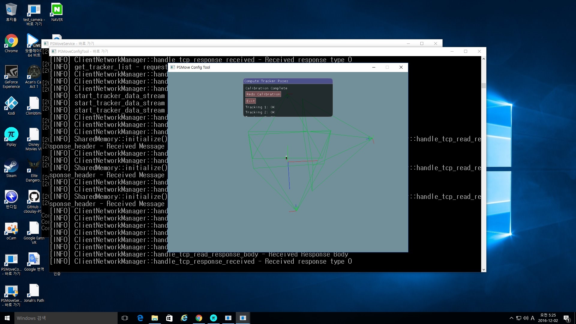

I saw how to install Oculus touch, then I ran a fun test with PSMove. As you can see in the video, PS3Eye was able to track PSMove 360 degrees with just 3 PS3Eye, and it was confirmed that the motion was also accurate and smooth.
PSMove will be a pretty good choice.
I tested the 360-degree settings using three PS3Eye cameras.
The camera is located on the front, rear, and right sides at a distance of 200 cm and a height of 160 cm from the center (play position)
I took an angle to the place where all the hands are on the screen.
After completing the above settings, check that the camera is correctly positioned in “Test Orientation”
It is a scene to check the direction of operation of PSMove and abnormality. If there is no abnormality here, operation is guaranteed in steam vr.
I ran the room setup, settled it exactly in the center of the play position, and set up the room in stand mode.
As a result of testing,
PSMove’s 360-degree operation has been confirmed to work very accurately.
The video below is to play Acan’s Call: ACT 1.
Thanks to PSMove responding exactly 360 degrees, it was even cleared.
