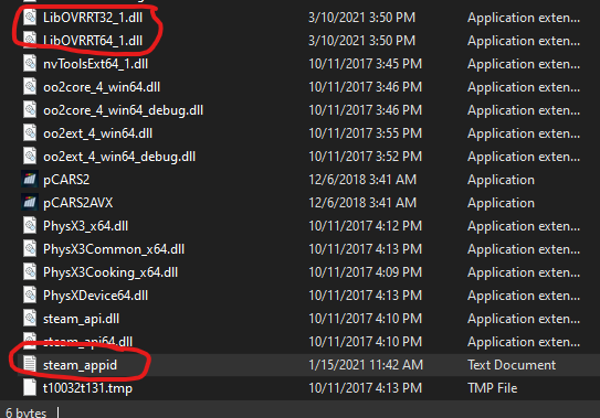

I currently have the Pimax 8k (not plus) and I’ve been really struggling to make Pcars2 run without PP.
I have followed all the tutorials.
Created the steam_appid text file with 378860 in it.
I’ve also copied over the LibOVRRT files in the game folders.
But everytime I launch the game from the PiTool (using the direct shortcut) it keeps launching steamVR and I get the crosseyes in game.
I’ve been using the latest pitool, and upgraded to the newest one today (V1.0.1.269) and still the same problem.
