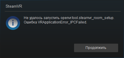

After disabling integrated card in BIOS, there are one more mode in option menu: pimax mode. But it’s not working, when i start a calibration utitlity, i have an error message:

Hi! I don’t understand Russian. Could u translate what the Steam showed please?
cant’start openvr.steamvr_room_setup
error VRApplicationError_IPCFailed
People from skype-support adviced me install nvidia drivers v. 358-362, i’ll try this too/
