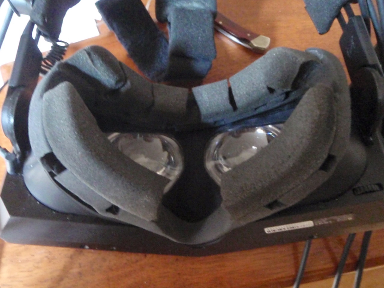

Desiring to check if using a thinner face foam would increase my FOV in the Pimax 8kX, i took out the original foam deciding to try whatever i had lying around, that turned out to be an old Gear VR face cushion from back in the day.
After applying and then entering SkyrimVR i couldn’t have been more shocked by what i experienced, all the descriptions i had heard described earlier were evident now and apparantly in full bloom, and at that moment i thought what the… this is not good, i hope this is not permenant but the fear crossed my mind for a moment untill i played around some more wandering on the path in SkyrimVR while making every adjustment to the hmd i could think of positionally.
Then to my relief i reached behind to adjust the ratchet mechanism by backing it out ever so slightly and i was back it was a miracle the game world no longer seemed distorted the fishbowl and odd distortions were completely gone, what a relief and for me a strange discovery for me so late in the game.
So from my experience today i hope that others will consider this lens to eye adjustment distance more critical to a better experience in their Pimax HMD’s.
Here are a couple images from today of my Pimax 8k face cushion and the Pimax 8kX alteration also from today.
I guess i just got luck on finding the perfect distance early on with both face cushion mods.
Pimax 8k
Pimax 8kX

In a nut shell what i’m saying is that my eyes were to close to the lens and once i adjusted them to the proper distance no longer did i experience that strange number of aberrations. Thin foam or thick foam its the distance that matters and is relative to a persons face shape.
