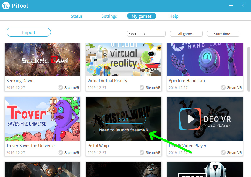

Playing games with pitool only, without steam vr
I read somewhere that we can play vr games using pitool game laucher only and uninstalling steam vr for better performance anybody knows if and how to do it?
It depends on the game.
If the game supports Oculus You can start the game in that mode instead of SteamVR/OpenVR mode.
Here’s an example:
https://community.openmr.ai/t/how-to-play-dirt-rally-vr-on-pimax-8k-5k-without-revive-and-steamvr/18578
In fact, @park has made a lot of guides:
https://community.openmr.ai/search?q=%40park%20how%20to%20play%20in%3Atitle
Ok thanks do you have to do that for every oculus suported games? and does it improve performance?
I think so, yes.
Only if the game required parallel projections to be on when running in SteamVR mode.
If not, I’d say performance is most likely very similar in both modes (both that might vary between games/game engines?).

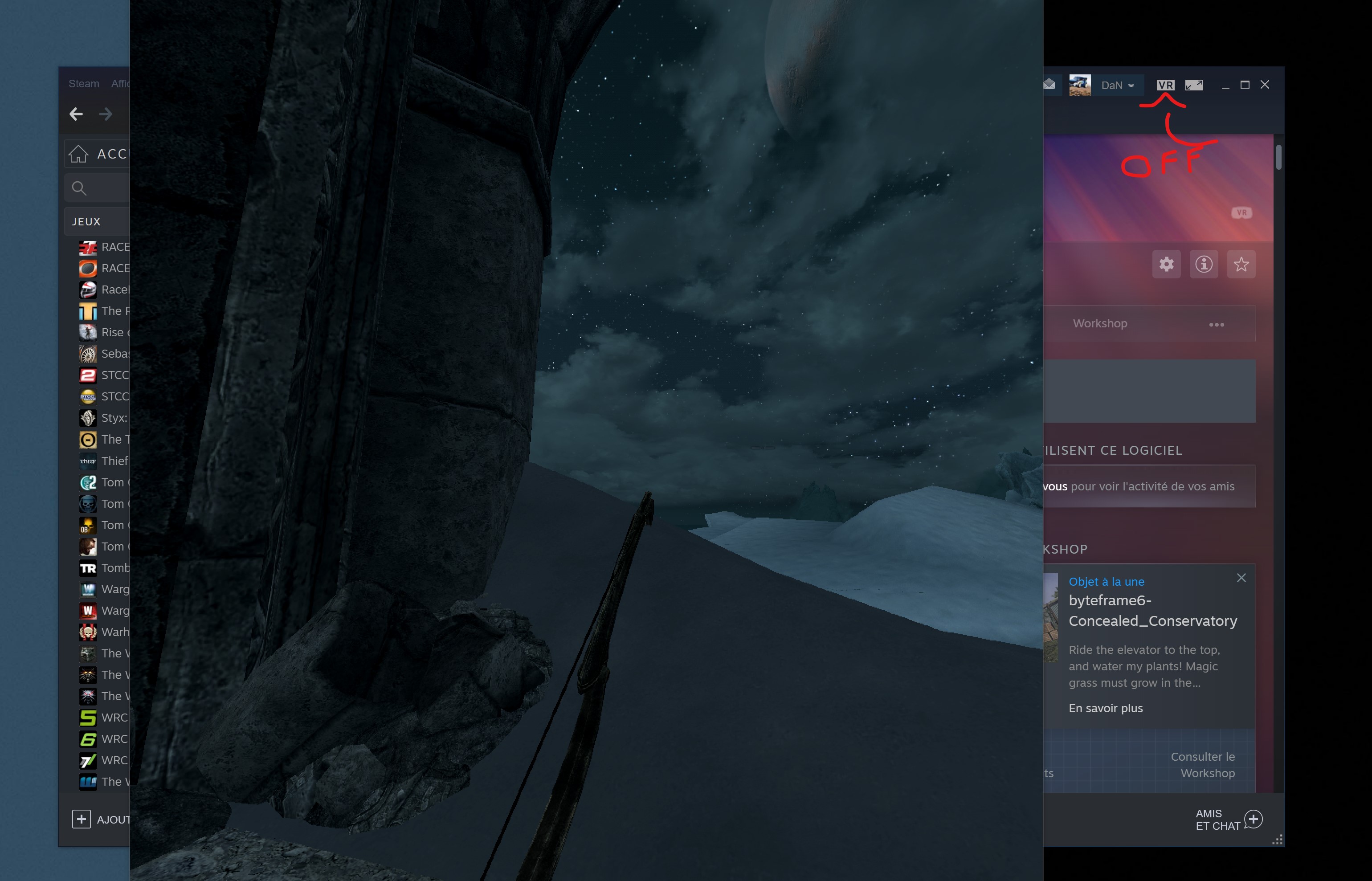

I Play skyrim without steamVR
Oh man… can’t find this option on the last steamVR version :sob::sob::sob:

From Steam,
A number of settings available in the old interface have been moved around a bit until they are finished adding them to the new settings interface.
This option can now be found at SteamVR Menu > Developer > Developer Settings.
Let us know if you have any other questions - we’ll be happy to help!
Steam Support
Jesse
