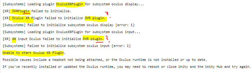

Here is the log of the error Pastebin

@drowhunter you should attach the log you got. As far as I remember, nothing in that log showed OpenXR being used at all.
Updated my original post with the logs

I suppose one way to know for sure: can you try again, but before, delete or clear the PimaxXR log file. Make sure PimaxXR is set as OpenXR. Try running the game, and lets see if a new PimaxXR log file is created. If so please attach the log. This will tell us whether they actually try to load OpenXR…

Still not convinced this version of the game uses OpenXR. Did you check what I mentioned above?
