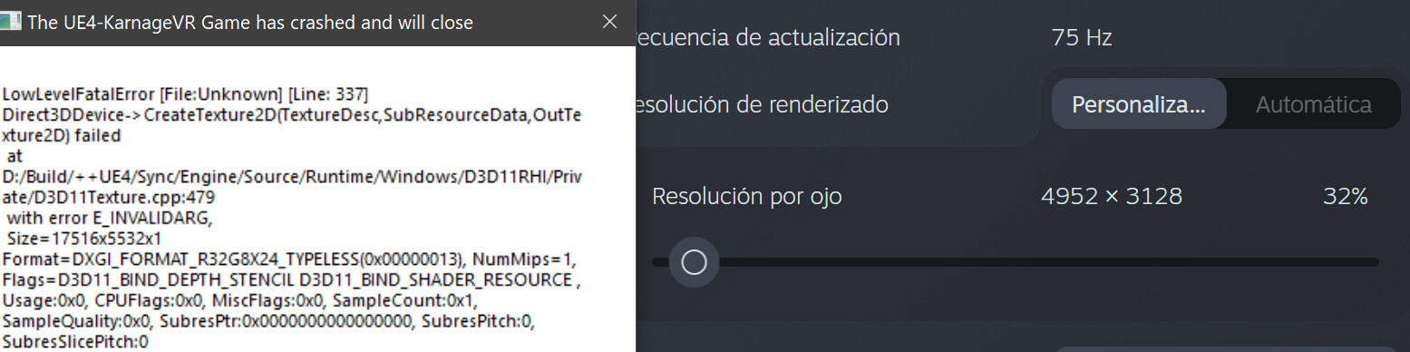

For me the pitool setting above 1.0 in 8kx is no longer a viable option, there are games that above 1.25 will fail at startup, regardless of what you do on steamvr, even oculus games will fail at 1.25 or 1.5

Karnage for example fails above 1.25, no matter what you put on steamvr or in auto

This occurs above 1.25, with large fov, with medium fov it seems to work fine at least at 1.5 and 1.75

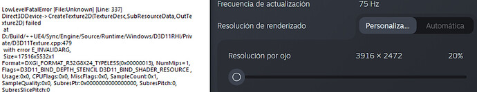

Though ‘normal’ FOV and RQ 1.25 is what I use when performance/quality margins are tight, this is nevertheless very interesting. How can these games possibly know what headset resolution they are getting from PiTool, as opposed to just what the SteamVR resolution is?
What is the recommended render target resolution, when this happens?
LowLevelFatalError [File:Unknown] [Line: 836]
Rendering thread exception:
LowLevelFatalError [File:Unknown] [Line: 337]
Direct3DDevice->CreateTexture2D(TextureDesc,SubResourceData,OutTexture2D) failed
at D:/Build/++UE4/Sync/Engine/Source/Runtime/Windows/D3D11RHI/Private/D3D11Texture.cpp:479
with error E_INVALIDARG,
Size=17516x5532x1 Format=DXGI_FORMAT_R32G8X24_TYPELESS(0x00000013), NumMips=1, Flags=D3D11_BIND_DEPTH_STENCIL D3D11_BIND_SHADER_RESOURCE , Usage:0x0, CPUFlags:0x0, MiscFlags:0x0, SampleCount:0x1, SampleQuality:0x0, SubresPtr:0x0000000000000000, SubresPitch:0, SubresSlicePitch:0

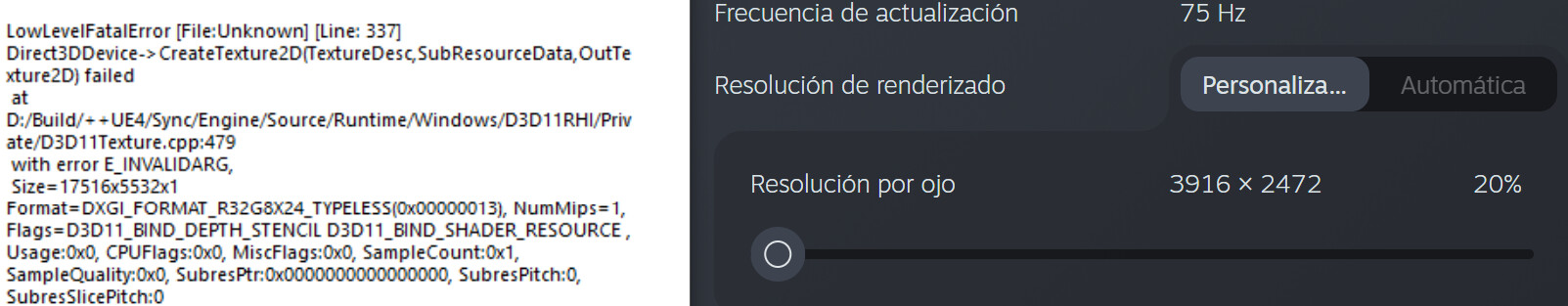

and here manually selected to minimum 20% and also crashing
pitool makes the texture output higher and does that cause engine problems?
I believe there is your problem. The game tries to create a texture of the size 17516 x 5532, which is too big for DirectX runtime (which only supports the size up to 16384).
Taking into account the recommended render target size vertical resolution (when it fails), which is 3128 and the fact that vertical res of the texture the game creates is 5532, you can calculate the supersampling factor the game applies as:
5532 / 3128 = 1.7685421994884911
now, using the horizontal res of the recommended res of 4952 pixels and applying the same supersampling you get:
4952 * 1.7685421994884911 = 8757.820971867008
and since UE apparently renders both eyes into one texture placed side-by-side:
8757.820971867008 * 2 = 17515.641943734016 ~ 17516
which is the faulty res.
Why the UE applies the supersampling I do not know, is there something in the game, which may control that?
Seems to me that 2472/sqrt(0.2) would be just slightly under 5532 (EDIT: …and the same goes for 3128/sqrt(0.32)), so it would seem to me a likely case of UE4 ignoring steamVR’s recommended render resolution, and somehow getting hold of the 100% resolution in its stead, as has been speculated now and again, rather than any additional supersampling on the game’s part…
