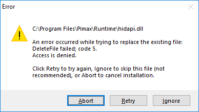

Hi Sean
During install i am getting the following error
access denied
selecting retry gives the same error
Eno
-------------- update ---------------
installing it as admin seems to work, will do some testing and benchmarks using it. note i did not uninstall the last piplay version, and it is still installed along side Dr Pi.
