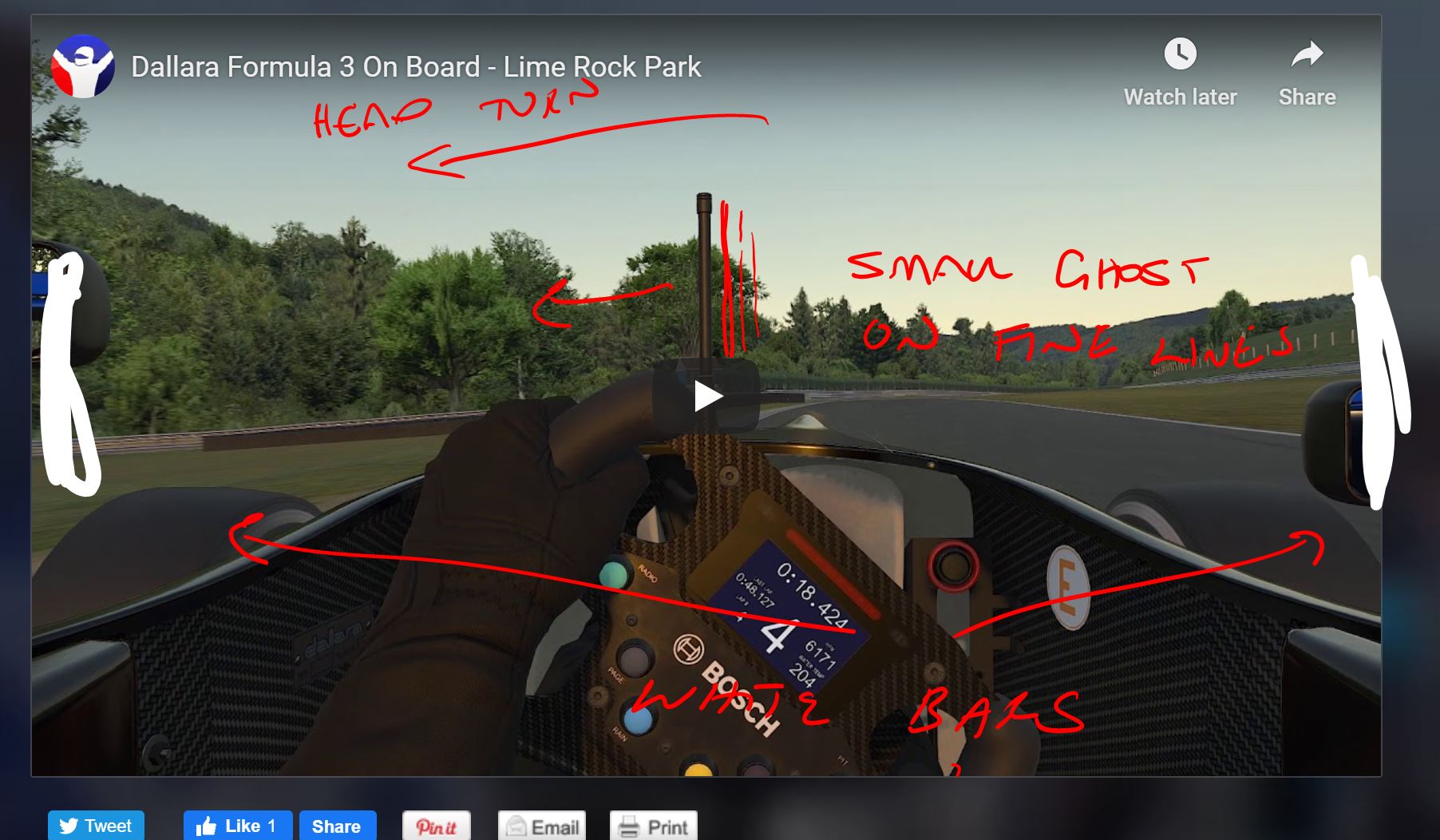

But FW264 does do 110HZ ,but i get a little bit of ghosting ( like panel persistence)
I get little white bars on the side at 110hz which is not there at 90hz.
Im staying at 90hz atm

attached is a pic of the issue i have with the 110hz, its like panel persistence.
it’s not a deal breaker but it is noticeable on my headset, I’m wondering if its because it’s an early model? Jan 2020.

@Alex.liu give a look to last posts of @darrenmnz
He has white bars on 110 hz in iracing (Known Issue)
and small ghost on fine lines when he turn his head at 110 hz
