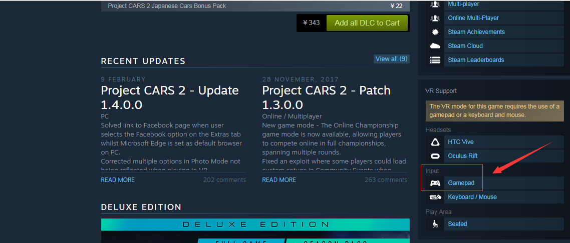

Usually as long as the controller is supported by PC, it can be used for some VR games that need Gamepad, e.g. Project Cars.
