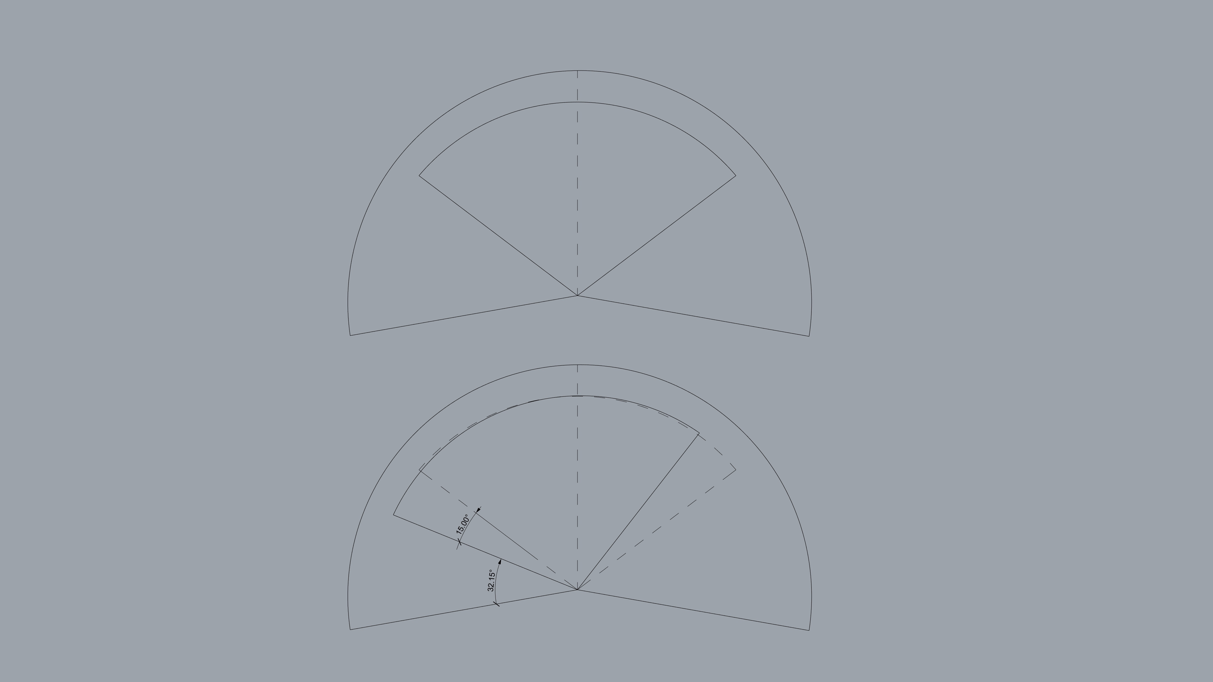

But it’s a good point, makes me think that Pimax could implement fixed foveated rendering since we ll never get full resolution at the borders. Not only for the GPU but also for the upscaler, perhaps we ll then reach the 90Hz?

This is what I am talking about. That’s 60° we ll never get to see in full detail so it doesn’t need full resolution.
