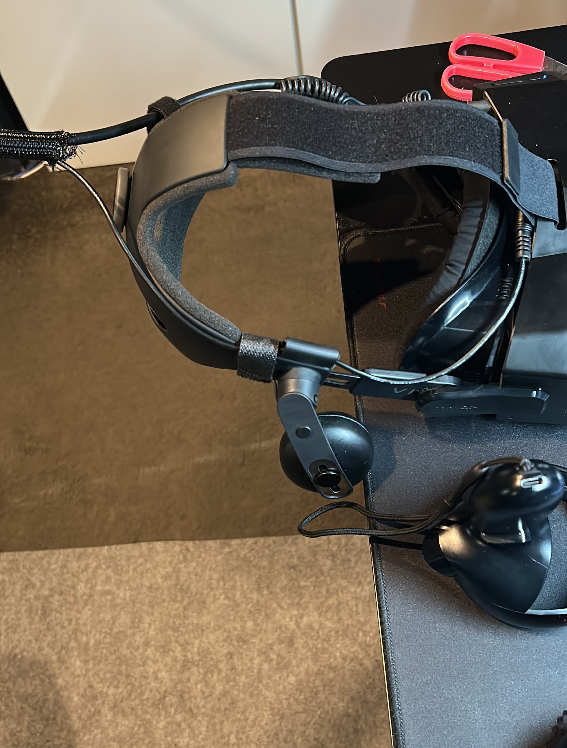

Finally, after examining the headset, I saw that I could connect it to an HTC DAS without making many changes. No changes to the Super, and I drilled a hole on each side of the HTC DAS. A bit of skill, and it fits.
The HTC DAS has a headphone jack. I then ran a 5m extension cable from the Super’s main cable to my PC and connected it to the sound card there. And lo and behold, the sound is excellent and, thanks to the HTC DAS, also the best wearing comfort. No wobble, the FOV is correct, no head strain, everything is secure.

Since I haven’t found anything online for modding yet, I’ll post some pictures here if anyone wants to see them. If you have any questions, I’ll be happy to answer them if I can.

  3. Did you replace the complete headstrap with the DAS, or just the speakers ? I remember there were printable adapters (had them on my 5K+ back then).

I replaced the entire headstrap with the DAS. You don’t need an adapter. With a little skill, it works.
The Super has a 3.5mm port btw, if you want to connect the vive DAS directly. It is still a bit quiet but I think that will be fixed soon, personally I use Boom 3D to make the DAS sound better and louder and it works well.
