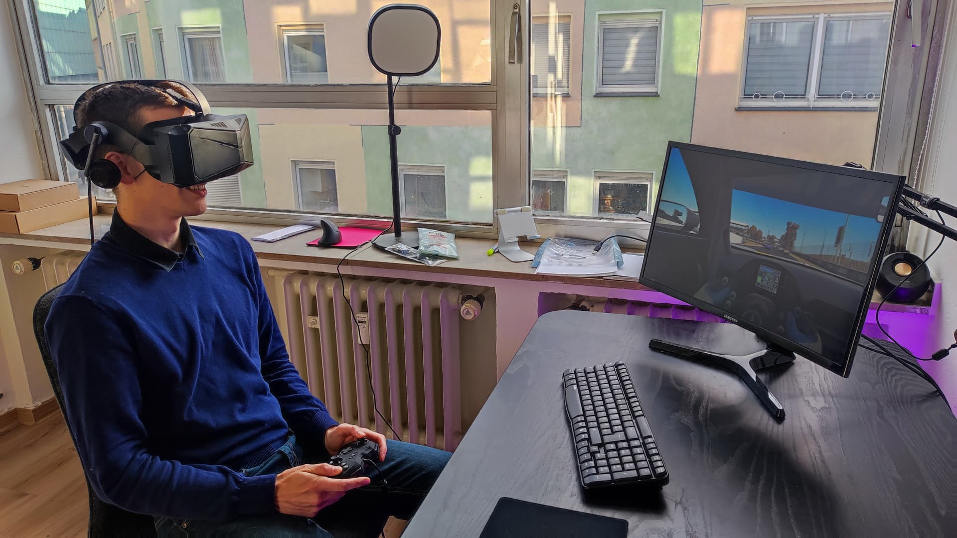

Firsts impressions of the Crystal from MRTV Headquaters.
[Uploading:
What did he say? I just had eyes only for Marcin on the ground. Watch your knees!
Ok, now I’ll listen. :joy:
Yeah, all I’ve been watching is the man with yellow shirt and blue jeans. Crystal’s headphone seems cool, and the cable is very thin. Is that the same fiber-opti one the end users will get ?
As I understand it, the Crystal will have a more robust and higher bandwidth cable. I think one of the problems- or maybe more than one- is the fault of the jury-rigged 8KX cables they’re using at the shows.
I don’t think any of the issues are significant in and of themselves, but the combination of them may slow things down.
I’m betting they’ll have a production model for CES, with shipping to follow that within weeks.
Maybe a tad sooner or later.
Looking forward to more indepth opinions!
