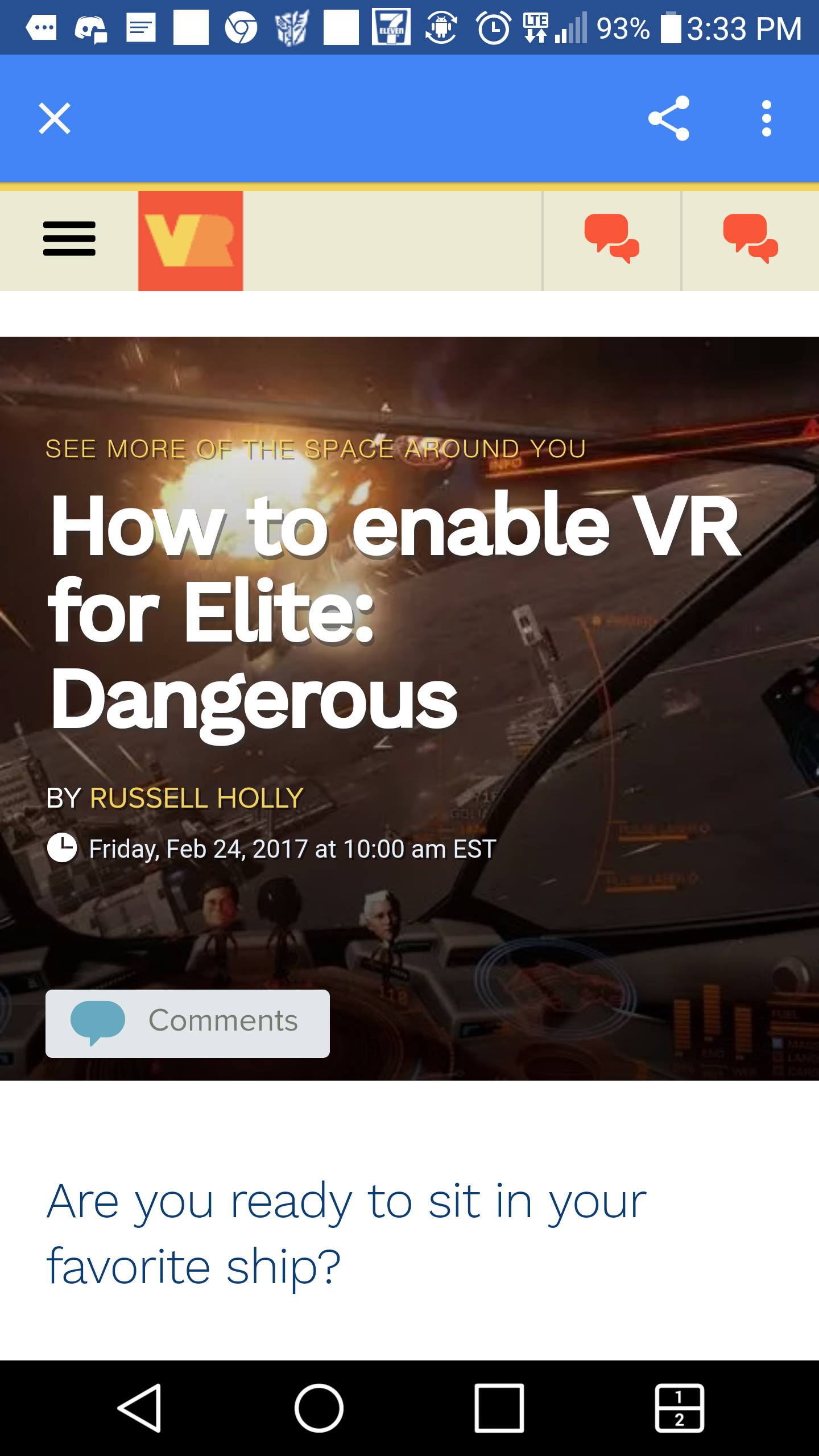

https://www.google.ca/amp/s/www.vrheads.com/how-enable-vr-elite-dangerous%3Famp
I don’t own ED but this link may help.
Thanks for the link.
Their solution is to uninstall the existing version, get a Steam key (provided by Frontier) and then install the Steam version. I’d hoped to avoid all of that if at all possible. Their information in the last paragraph is also incorrect as I understand from Frontier, in that the game will happily launch Steam VR when it is put into VR mode using the approach I originally took.
I’m also a little cautious, since I have tried - successfully - to add Elite to Steam and launch it through Steam VR. It would launch successfully, but it wouldn’t run on the Pimax, though I had it in Pimax Mode at the time, which seemed the be the problem when enabling it through the graphics options menu. Steam VR started as expected, but it would run only on the primary display.
Unfortunately according to the link i provided the old method no longer works. It seems they have made a special version of the game for vr purposes.
As you can see this article was released february 2017.
There is no way to enable VR mode for Oculus Rift or SteamVR from the standard PC version of the game anymore. Before you uninstall the game, be sure to head to Users/[accountname]/AppData/Local/Frontier Developments/Elite Dangerous/Options/Bindings/ in Windows and move the “custom.binds” file until the game is re-installed.
Now you should be able to backup your current ED by renaming the game directory or making a copy of the game directory. Then install the one with thr steam key.
If your looking to run with Hotas controller there is a trick that involves running the launcher outside of steam. Folks like @lukeb have experience with this. I do apologize though to the fellow that initially posted the solution for luke.
