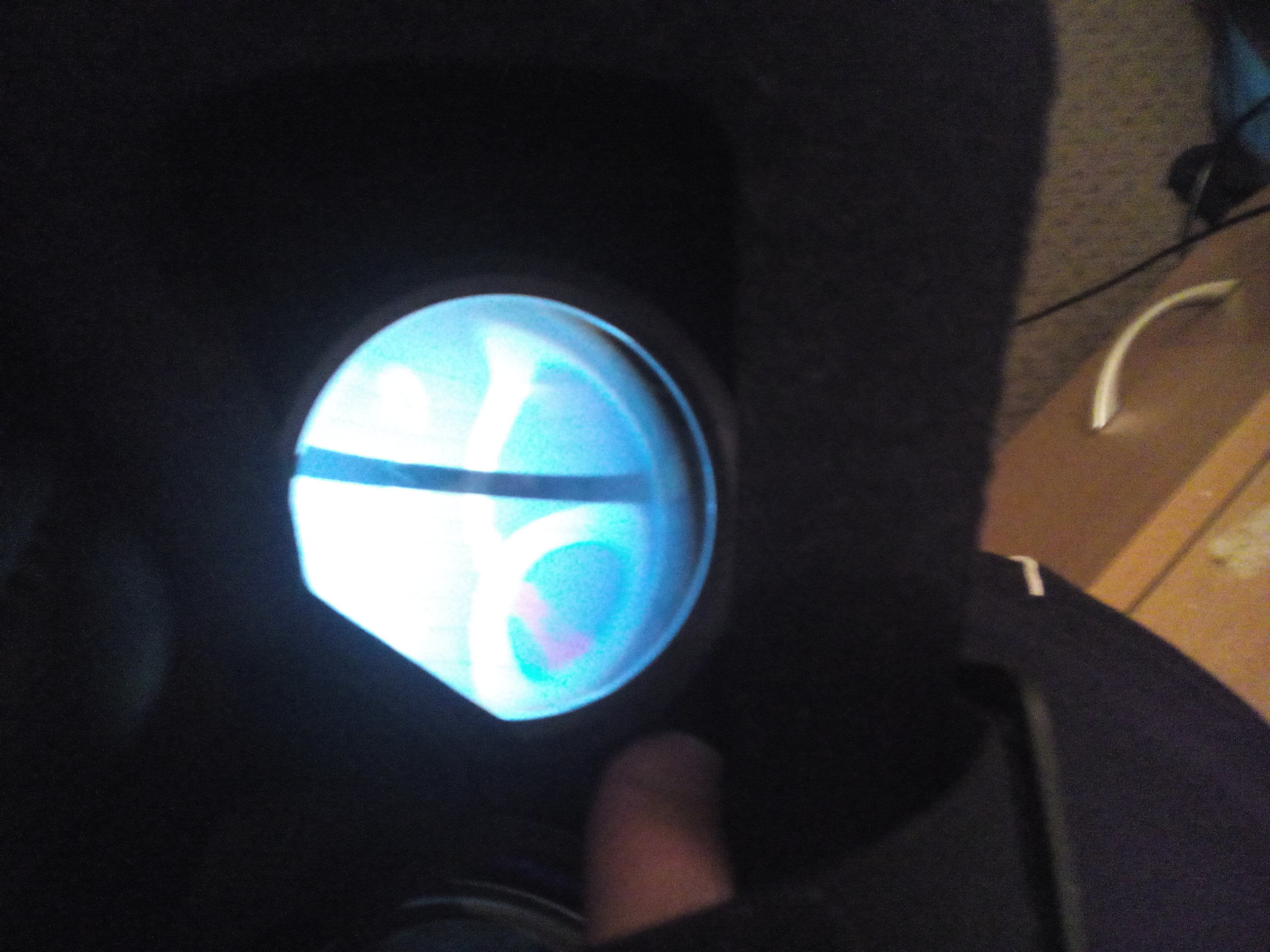

I recently purchased a Pimax and it had arrived today. I’ve set it up and I’m having a fantastic time sussing out how the thing works.
There is one question that I do have however, the left eye has a black line going vertically through it, it’s reasonably large and fairly noticeable, and I’m just wondering whether this is in fact normal, or, if it’s not normal, if there is any way of fixing it?

Here is an image of the black line. I hope this helps make a determination about the headset.
Cheers,
MrAussieGuy

BullGod Writes:
I found that Piplay 1.2.57 and the 248 firmware causes some odd light
black bars in the HMD. I just spent a few hours ‘fudging’ with it, and
it now appears that it is the piplay version that was causing my issue.
Once I downgraded back to 1.2.53, the black bars are gone (but the rez
seems lower or less clear). With 1.2.57 the HMD seemed more clear, but
the black vertical bars killed it.
I AM happy that I was able to roll it back and make the bars go away though.
Try downgrade the version piplay.
Cheers, I will downgrade PiPlay now and have a play with it.
Update:
I downgraded the Piplay software and now the line shines very brightly, like, way brighter than the rest of the screen. I put my finger on the sensor and noticed that part of the headset is constructed by a set of strips of some description, and it appears that one of the strips is missing, which is where that bright/black line is appearing.
Is that a defect, or is the headset meant to be built like that?
