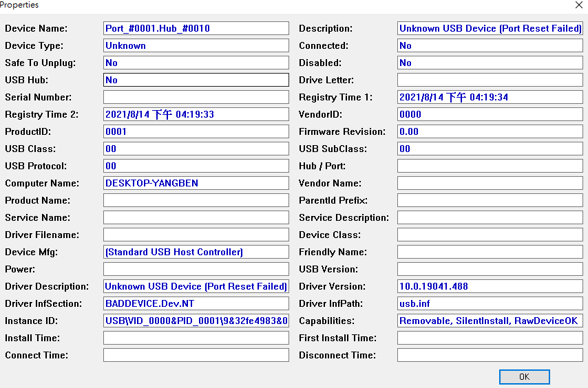

OS : windows 10 21H1
motherboard : ASUS zenith extreme
video card : msi rtx 2080 ti lightning z
video driver : 471.68
USB hub : BENEVO BUH334 industrial USB hub
Pitool ver : 1.0.1.271
left-hand side is usb3.0 port, right hand side is usb 2.0 port
(Note. when 8kx connect success, it would be usb3.0 : 4.91V/0.55A, usb2.0 : 4.99V/0.25A)

Not really readable. I see an external hub that shouldn’t be.
Have you ever plugged the HMD ALONE into an internal 3.0 hub of your PC? So also not additional to the socket on the left and / or right.
