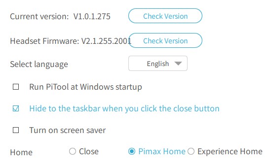

I am here to inform the interested forum members about my 8kx. It is back online. The solution was not the new vga, reinstall windows, reinstall nvidia driver, disable mainboard vga. The solution is a special firmware version thas was sent by Pimax support. I have never seen this version around the Pimax user’s tales.
It is a special V2.1.255.2001.
File name is: P2_DEBUG_8KX_N7_0_M299_t20211203180915_rc879f9b_90only.dfu
So my 8kx can work only with this firmware. I have no option to change an earlier version or so. I am not sure what happens in the future, when pitool wants to auto update its firmware.

2001 appears to be new firmware currently under development for the 8KX. It seems to be unreleased and only appears pre-installed on some new 8KX purchases for reasons unknown. Perhaps a new internal revision of the 8KX hardware requires this new firmware (which would explain why all older versions of the firmware do not work on your unit) or perhaps the inclusion of this firmware on some newly shipped 8KX’s was a mistake. In either case, it seems that support has offered you a development build of the firmware because they believed it would fix whatever underlying technical problem you were having, and it seems to have worked.
I suspect that you’ll actually be okay on newer firmware releases in the future because presumably whatever you got in this development build that fixed your problem is what’s coming in those future official releases.
That the firmware is titled as “90only” suggests that there may be a different fork which is not 90Hz only as you have suggested in a previous post.
Perhaps Pimax is going 90Hz only for newer customers (such as seems to be indicated by their website advertising updates) but are splitting off firmware for older customers which retains previously advertised capabilities for them (lower refresh rates, upscaling mode, etc) so as to avoid taking those away. In such a case, the previous firmware fork would likely be maintained as bug fixes only. While the new 90Hz only firmware is where all new features and development goes.
