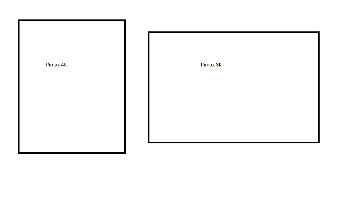

And here’s the resolution: 4096x2657 on the eye with SS 1.0
The 4K version had 3224x1989 [or 1612x1989 for each eye] by default.
Well, on this resolution, you can already judge the relationship between the parties and the wider FOV. Roughly speaking, in 4K the ratio was 16:20 per eye, but here it was 16:11, which indicates the superiority of the width above the height. And in 4K was the other way around.
A clear difference in the aspect ratio between:

the drawings are per eye right?
