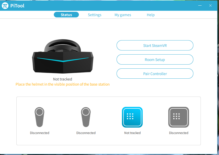

Pimax 5k Plus " Not Tracked " HTC Lighthouse
Hello,
I recently received an HTC base station but cannot get it to track my Pimax… I have read through like 30 posts on the forums about how to possible fix it but nothing has worked… I have tried deleting the pimax folder in programdata but that did nothing either.
Anyone know what to do?

I get this every time I start PiTool and turn on my HMD. After receiving this screen I simply turn the HMD 180 degrees for a few seconds by holding the top head strap and the icon turns from Not Tracked to Ready. It works for me 100% of the time.

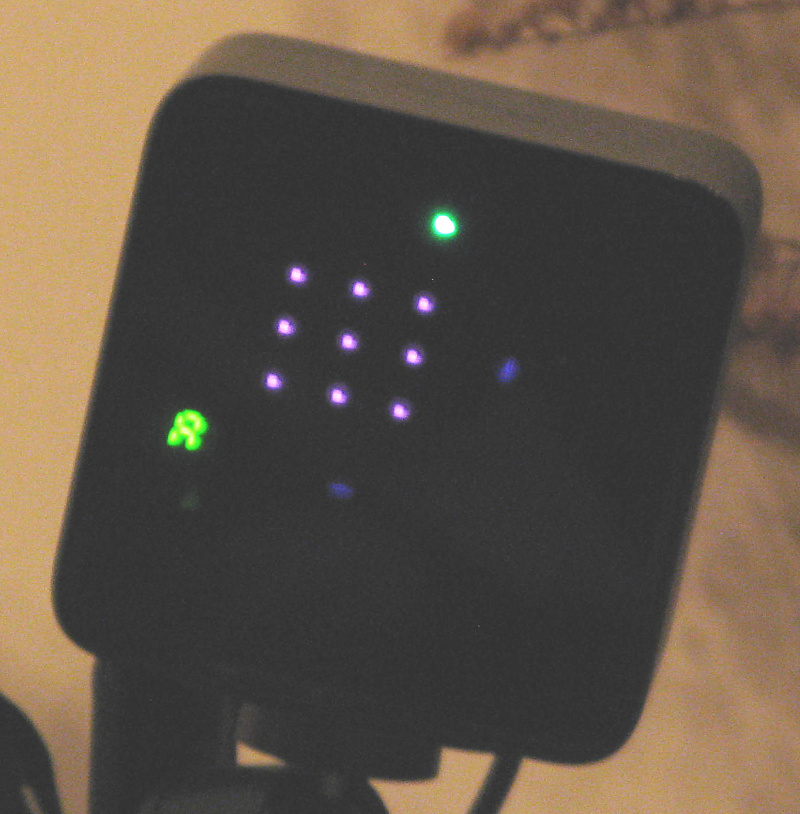

Just noticed that the base station is missing a laser on the right hand side… what does that mean ?

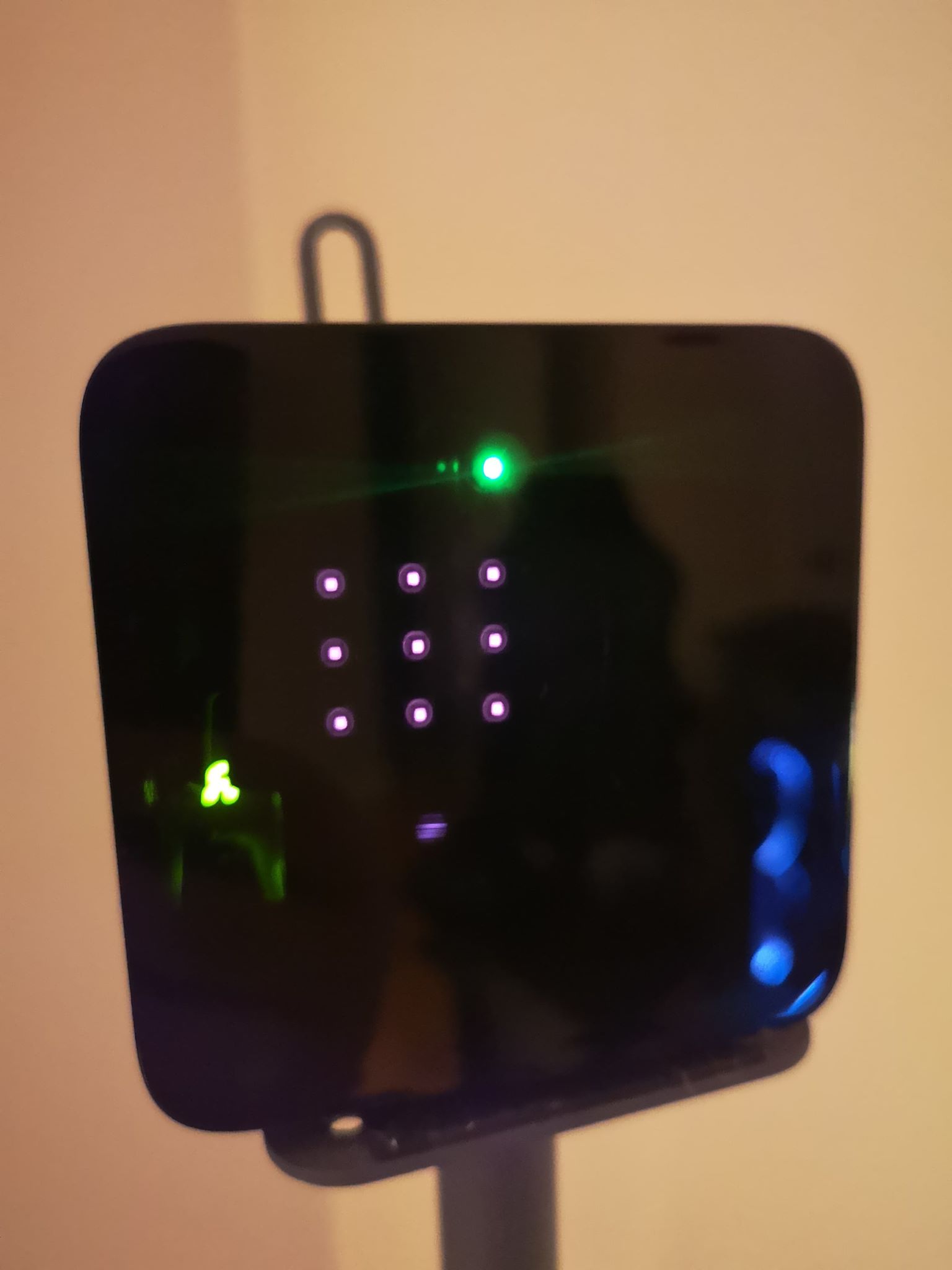

That can’t be good. Mine looks like this:
Unfortunately, that looks like a hardware issue.

Yeah the vertical tracker is not emitting light… so yeah lol. I bought it used for a good price but sucks to lose money
