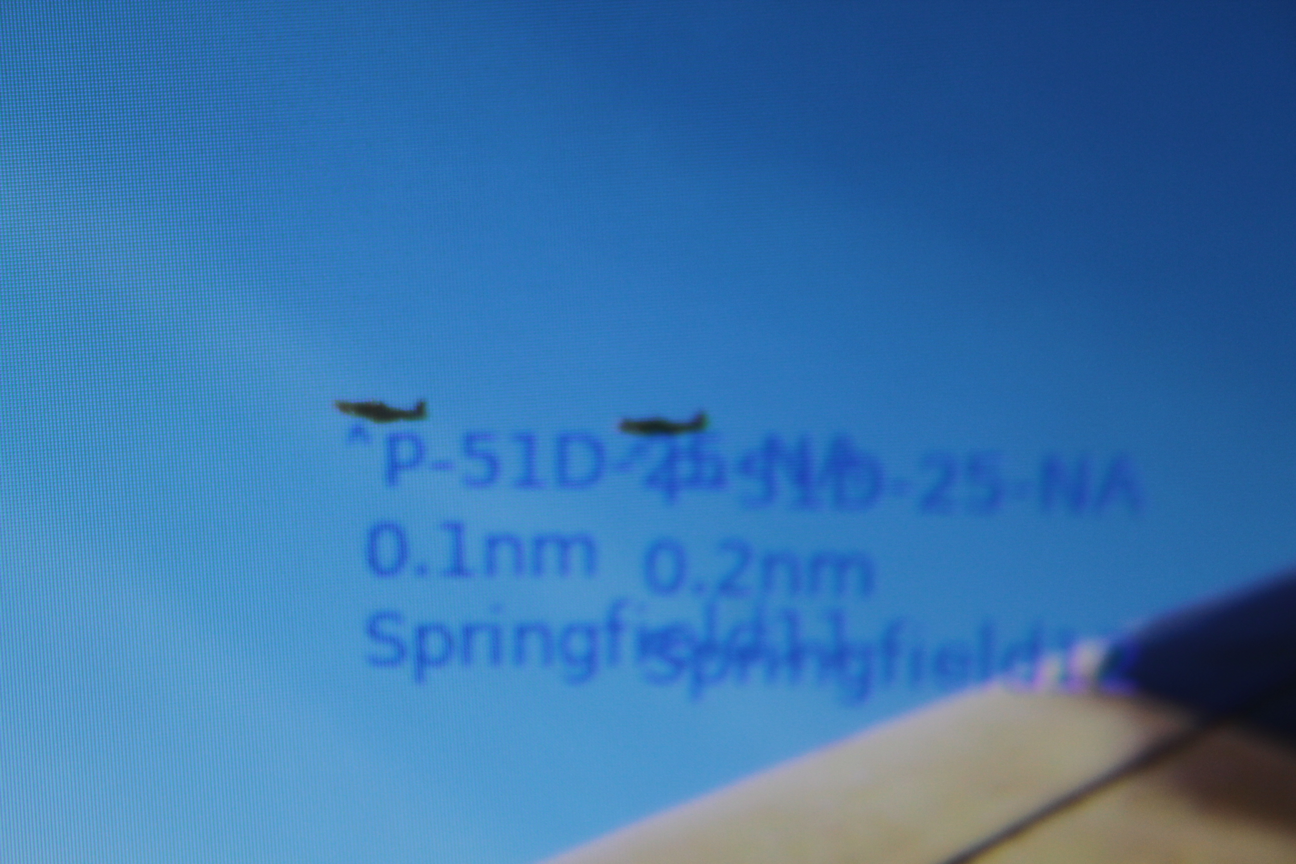

However I changed oversampling FOV etc… the view out of the cockpit is still blurred. Planes are almost surrended by some red/white pixels.
To add to the probleme looking with my left eyes shows a charped letters display but not with the right eyes. I had to move the headset manually to find the spot making the letters sharppen.
I previously manually set up my IDP to 70mm.
Any idea? bad making ?

I try to take an “trough lenses” picture with my samsung but it is not “pixel brighting” and it didn’t focus right.
