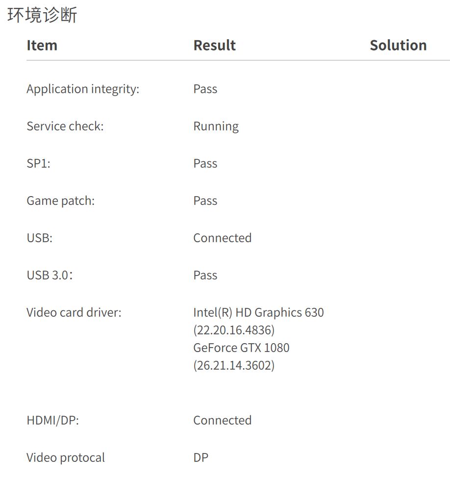

In Pitool click on help Tab & choose Diagnose. Post Screenshots of output.
This will check application integrity & show if pitool is seeing your Nvidia. You might need to change something to ensure Nvidia is ouputting through DP.

Yes I already contacted support - waiting for their feedback. It’s a laptop with a G-Sync screen so the Intel HD Graphics is not being used by the system as far as I know - I also tried to make it run by disabling Intel Graphics in Device Manager, etc. Anyway here are the screenshots:
