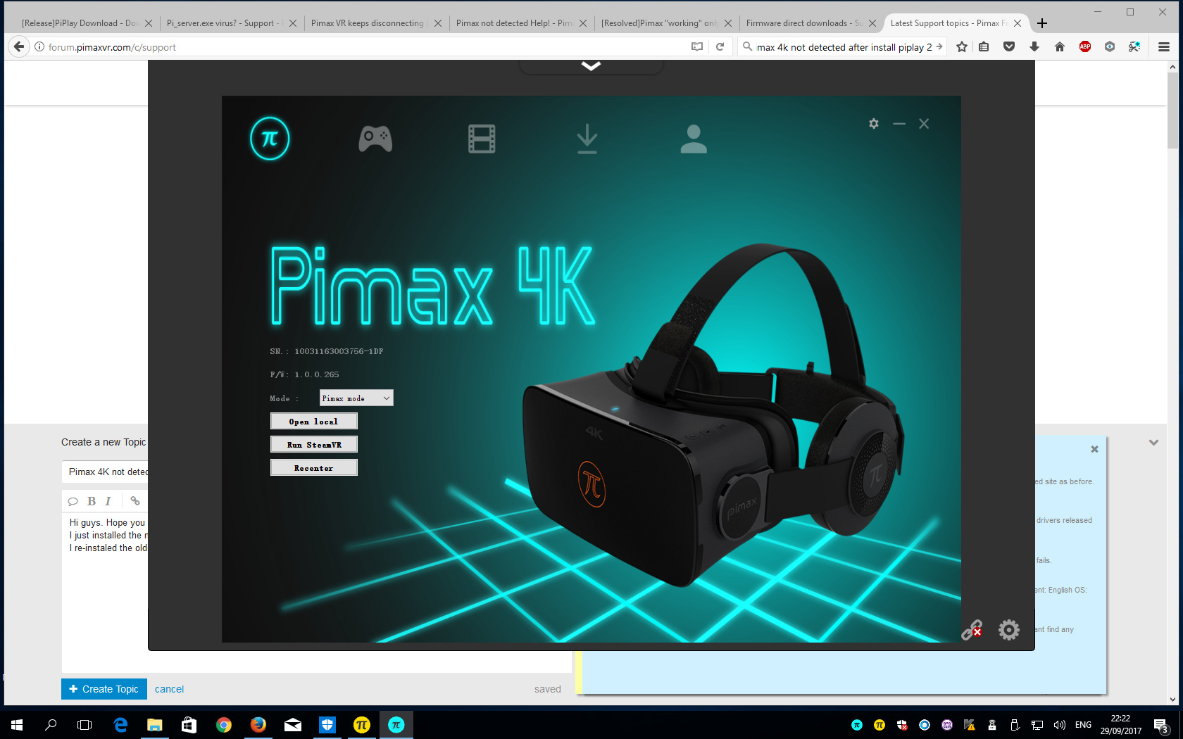

Hi guys. Hope you can help me.
I just installed the new version of PiPlay and my headset is not detected anymore.
I re-instaled the older version of PiPlay 1.2.91 without removing the new one and it works just fine.
Screens shots of the 1.2.91 and 2.0.3.38
