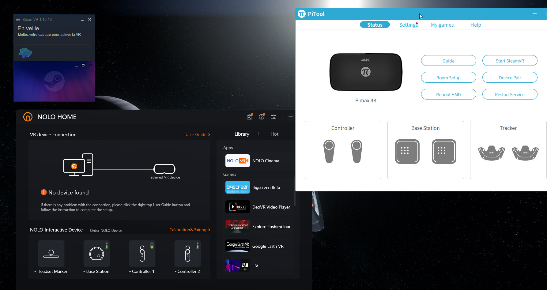

but i m stuck, because no way to found how the nolovr works with my pimax :
SO i install pitools and the headset works no probleme, but the nolovr nothing ??
What i miss, i think we need piplay, but all link are dead someone can explain me how play again on my pimax4k thanks all

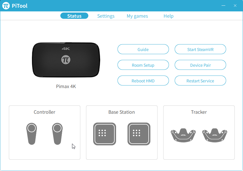

My pitools :

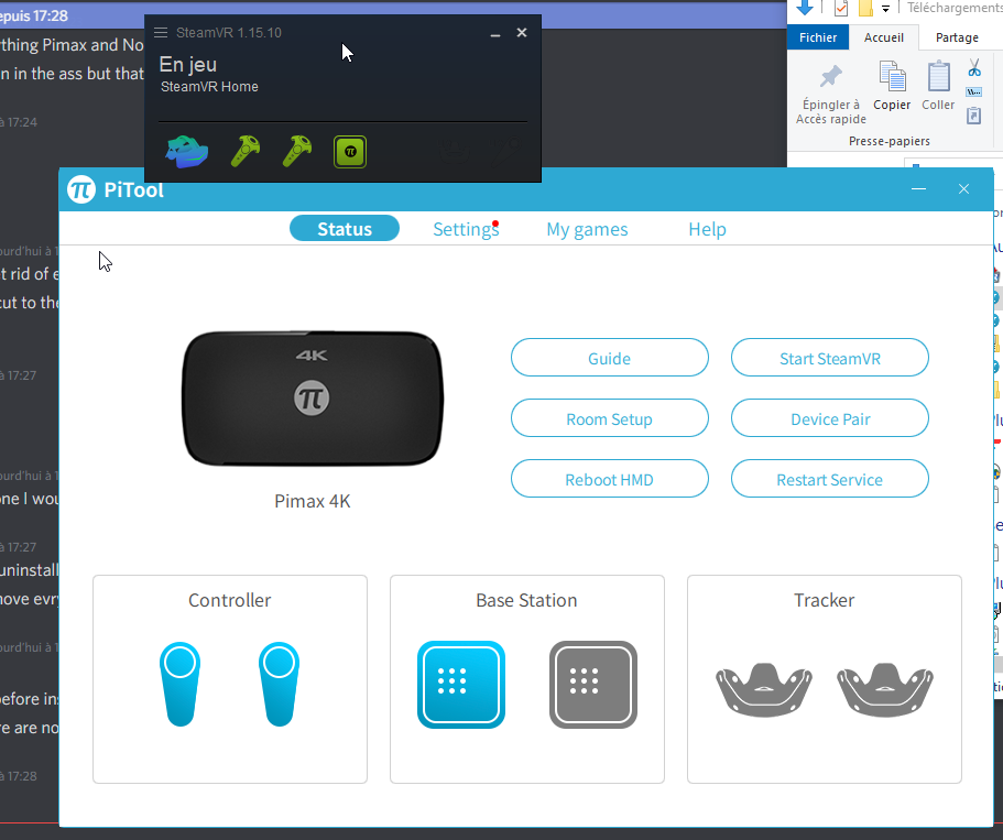

i install Pitool V1.0.1.264
so now i start SteamVR, i do the room setup, i repair all nolo (controlers, base, headset tracking)
Now :
i start Pitool V1.0.1.264
i start Steam
I start SteamVR
and now
the headset tracking works, the controlleur are not in the 3D view, but i can push buttons.
i can turn in 360 with controlleur.
But i can’t show the controleur nothing are in the 3D view
is better, but still missing the controlleur in the 3D view - i can’t found them in the 3D view !
i reset position, i push button nothing appear
the things is i can move, only the head in 360 and not move far way my place:/
is better, still missing a thing

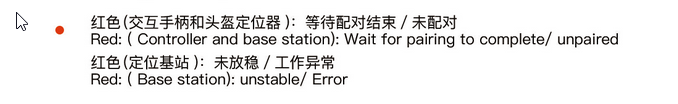

my base station is still the red light fix that’s means a sync problem with controleur :confused:
https://www.nolovr.com/pairing?treeid=002_1
so my base station is still red light fix on it
and the other things :
on the face of the bases station u need to have 2 red light blinding, and on my nolo i have nothing
