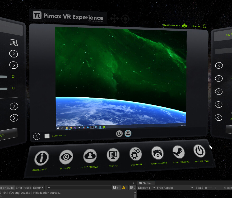

  • Virtual Desktop mode is located under the “Desktop” link in the bottom menu bar.
  • Virtual Desktop mirrors all your PC monitors (multi monitor support for up to 3 monitors) but you can only view one at a time (we will add simultanous multi-monitor view later on…)
  • Switch between your monitors by clicking the monitor icons right under the virtual desktop view.

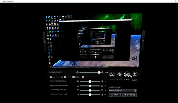

  • Virtual Desktop mode has also been added to Calibration page (currently only main monitor 1), so you can watch video clips or browse images on your desktop when calibrating your Pimax HMD (this is still work in progress and will be improved)

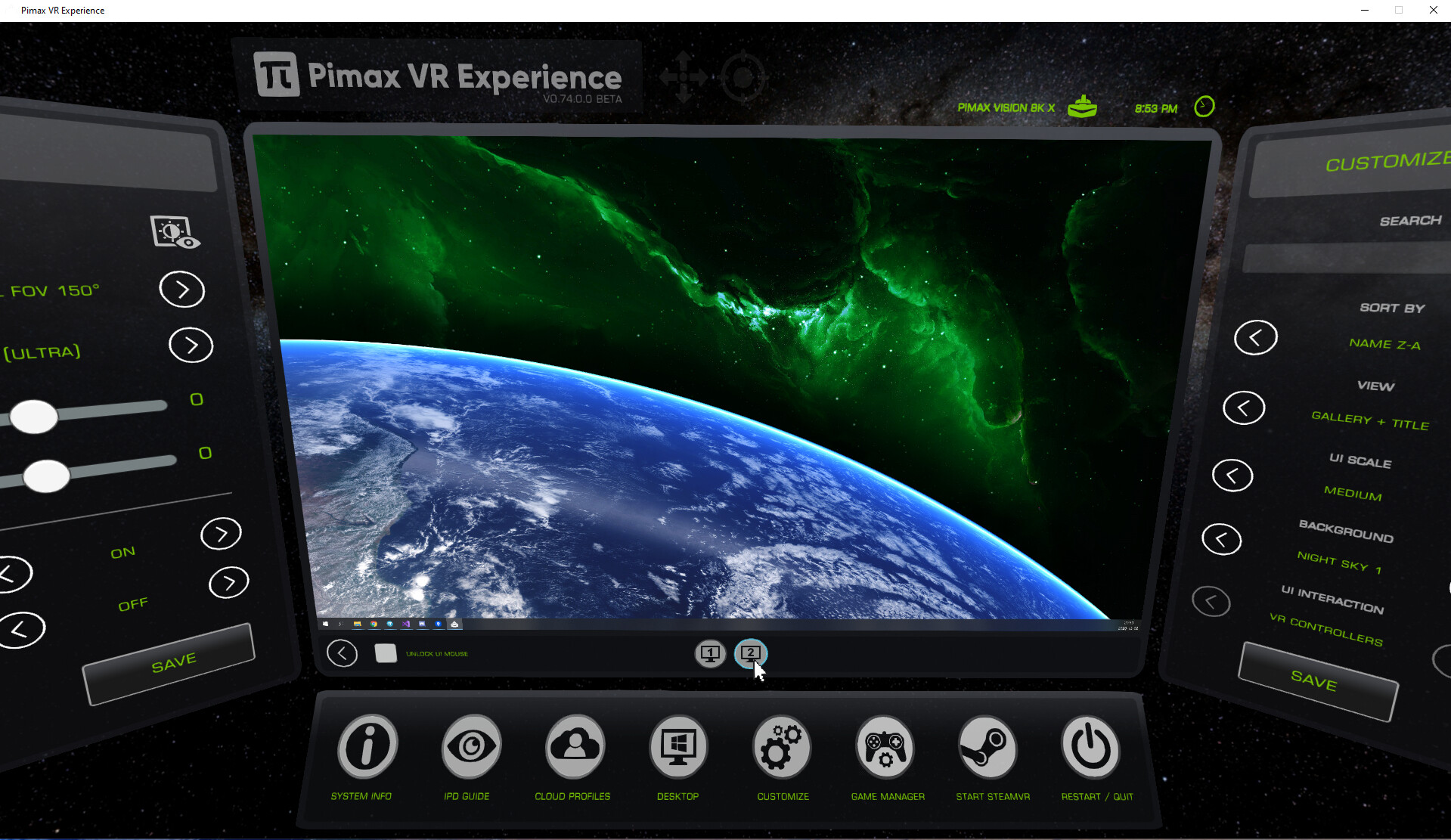

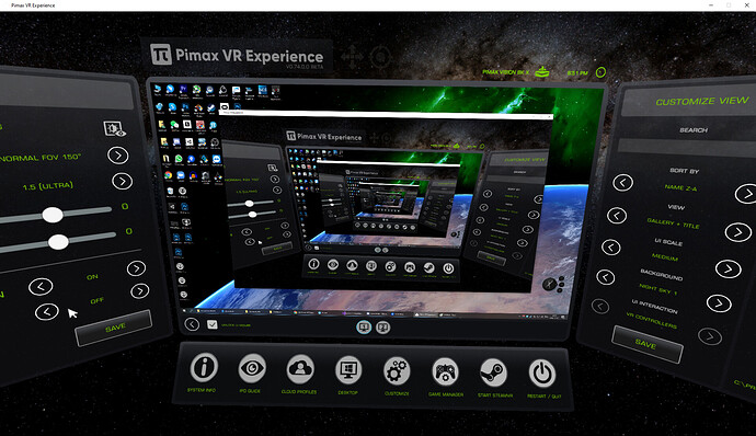

Works!
(as described above)
I can use the real mouse with UI unlock - as described.
Only the mointor order is diffrent then the laout (I have basically 2 1 3 the number placed at the physicall position)
And the Real World (sorry for the late night chaos - i know I need to clean up)

The UWHQD is a little bit squished (21:9) - but not much as its wider normally then the window area in VR (if you look at the picture in VR the icons seem more lengthy then on the desktop).
You would so either need to make “black bars” on top and beneath or change the ratio of the “middle” VR Plane to fit the wide ratio.

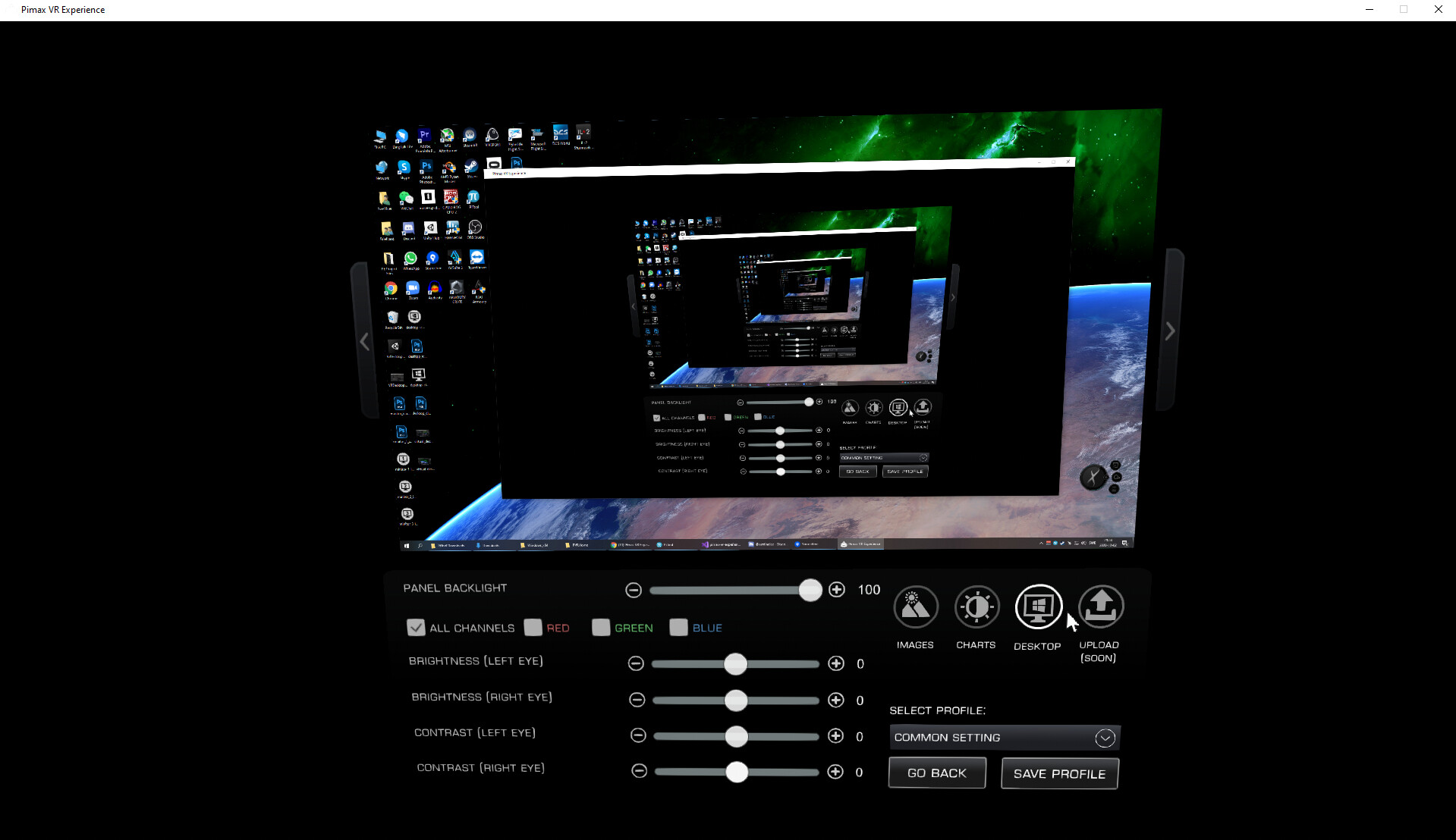

At me at 21: 9 (3440x1440) it looks flattened horizontally, unfortunately ( or stretched vertically).
Here I see 2 ways: to teach PE to stretch the virtual screen to 21: 9 mode, or to translate 21: 9 to 16: 9 so that the geometry is not distorted (but I’m a little sad here).

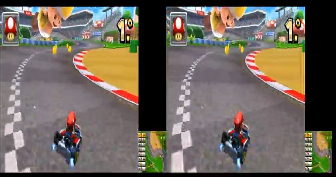

Since your going to go this far can you add support for Half Side By Side Stereoscopic 3D mode so that I can play games like this? In 3d without having to rely on Virtual Desktop?
Citra 3ds Emulator

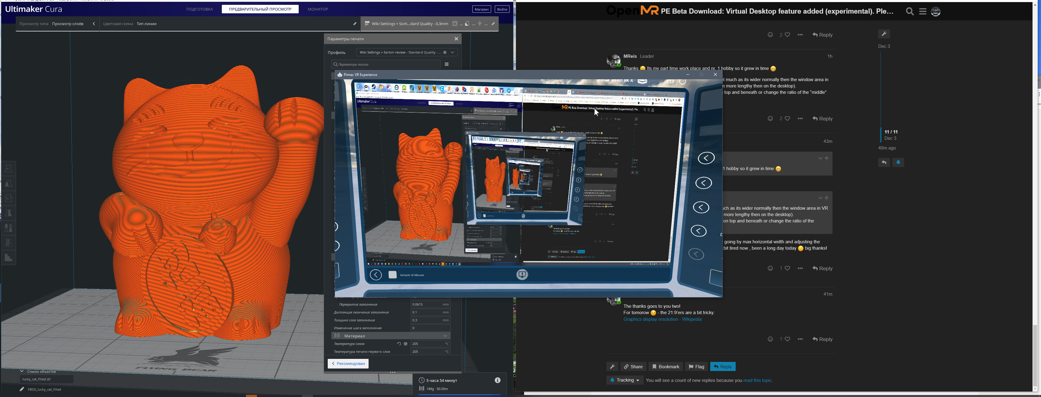

It works great with 3 monitors, but as expected, my ultrawide monitor (3840x1600) screen ratio isn’t correct.
But I’m impressed by the 8kx clarity… Even if I’m looking at a shrunk and stretched 4K monitor in a small VR window, I can read all the small characters easily!

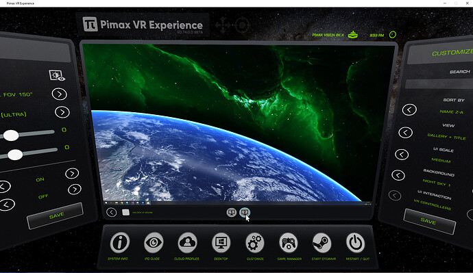

By the way, just re-factored the code a little and now all ARs are working :slight_smile:
When AR is 16/9 or wider than 16/9, max X width is set and Y based on AR
When AR is narrower than 16/9, max Y height is set and X based on AR
Now this will work much better outside of UI (as mentioned above), but at least all windows fits and scales properly in UI.
1920x1440 (4:3 AR)
3840x1440 (24:9 AR)
