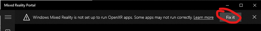

One more question - how does one switch the runtime from pimax back to G2? I’d like to intermittently use both.
When you open Mixed Reality Portal for your G2, there is a prompt at the top:
To switch back to PimaxXR you use the PimaxXR Control Center app and select PimaxXR.
