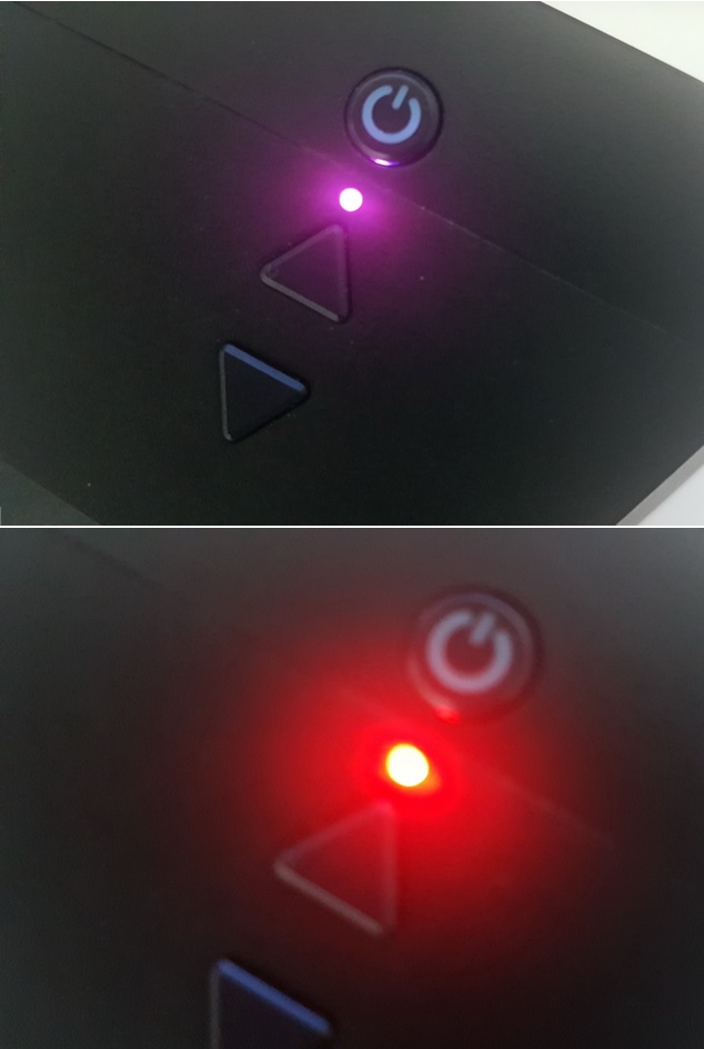

On/Off Led indicator: purple?
Does anyone know what this means?
The led indicator was GREEN (when hmd ready) untill yesterday.
From today is PURPLE:thinking:
Nothing has changed and I still have the last Pitool release and not the new beta
I thought it meant the ‘parallel projections’ option in pitool was turned on (needed for some games). Is the blue chevron on the front flashing also?
Purple is Parallel Projections on as @markd said.
Here is a link of interest.
https://community.openmr.ai/t/faq-getting-started-5k-8k/9468/3?u=heliosurge
There are other links in Pitool Downloads link in Banner
You right.
I’ve decided to use it because when I move my head (left and right) I’m noticing a kind of popping/flashing (hard to explain) in and out at the edges. Using the parallel projections the situation is much better. I have no idea how much more power is required but to me is useful. May be with the forthcoming Pitool updates will further improve.
