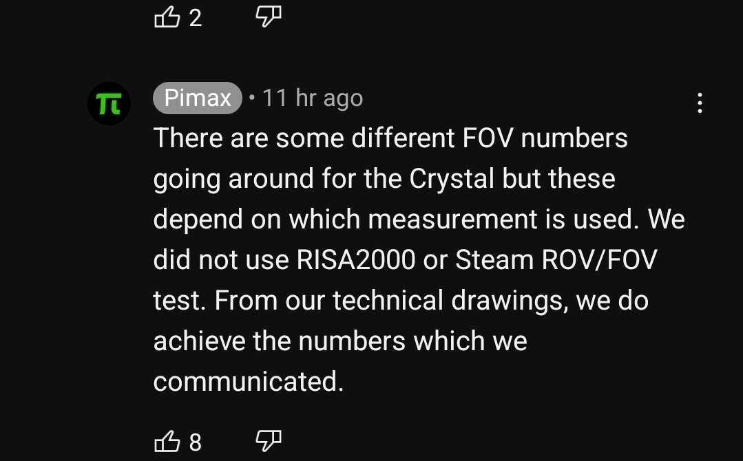

Official response from Pimax in regards to the FOV of the Crystal
Took a long time to get one, it turned up within the youtube comments of the wide FOV lens video:
So seems like they aren’t denying the 103 horizontal and vertical numbers from Risa2000 or TestHMD etc but Pimax calculate their FOV in a different way which results in 125 horizontal.
I am glad we finally got some response. I’d like to get more information on how Pimax calculates FOV and why they choose to do it this way, along with whether it’s common practice. It doesn’t seem to match up with the rendered FOV vs advertised FOV that we see from other companies.
Anyway, personally I’m happy with 103 horizontal and vertical. Perhaps Pimax could consider advertising their FOV in both ways? Like how speakers have peak and rms wattage ratings (obviously not the same thing but I mean that sometimes a single commonly advertised number can be presented in more than one way on a spec sheet, while the best version of it is used for advertising).

Yeah. this response is welcome and appreciated.
However, yeah, to your point, it’d be nice to understand how they arrived at those numbers and how that translates into actual real-world experience/numbers. Esp. in comparison with other headsets and esp. their own PIMAX 8K
There is definitely someone, somewhere at Pimax, who can calculate the FOV correctly. Unfortunately, he/she is not able to communicate it to the marketing/PR people, neither he/she can point out the absurdity of the official communication.
Yeah, this statement is pretty daft - essentially it tells the prospective customers that Pimax sort of very deliberately choose to use their own measurement from technical drawings, which leaves it completely in the dark as to how this is done, meaning they could has claimed 150 or 200 degrees of FoV, doesn‘t matter, you have no clue how they measure it anyhow.
And they top it off by stating that they have not used any tool which would allow to compare Pimax FoV degrees to any standard used elsewhere, which would enable us to come up with a formula, e.g. 1 Pimax degree equals 0.78 Risa, etc. degrees.
