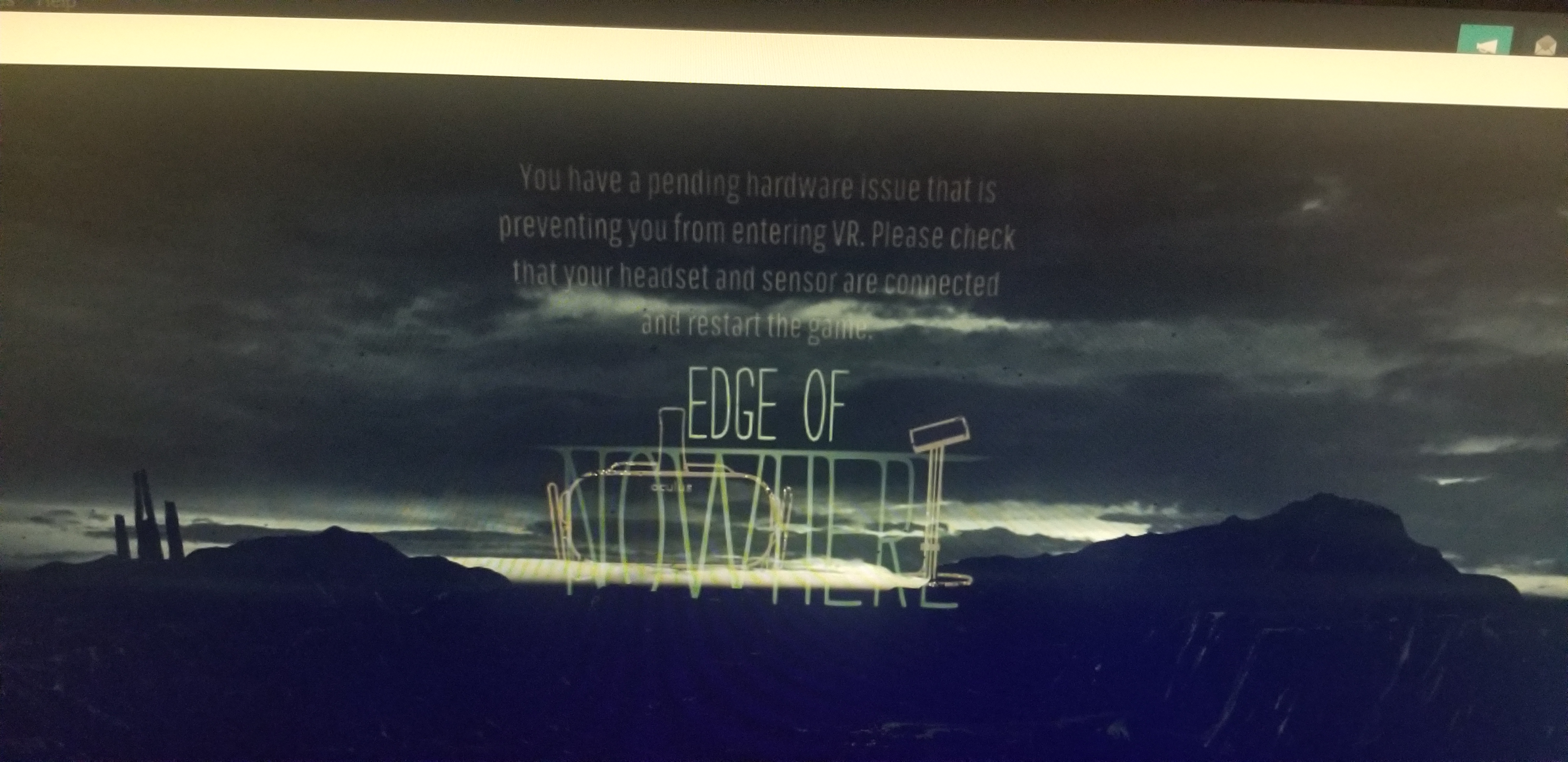

A few moths ago i was able to play the oculus game “edge of nowhere” on the pimax 8k.
I have tried today and either the headset panels remain black and the booting of the game freezes (if booting the game from pitool) or i get the message in the attached file (if booting the gane from my oculus library)
Is there an issue with my firmware and pitool version for playing oculus games on the 8k?

Are you using (by chance) 3DoF ?
This is either 3DoF (double check it!!!) or the basestation can´t see the HMD (which is required before starting the game).
